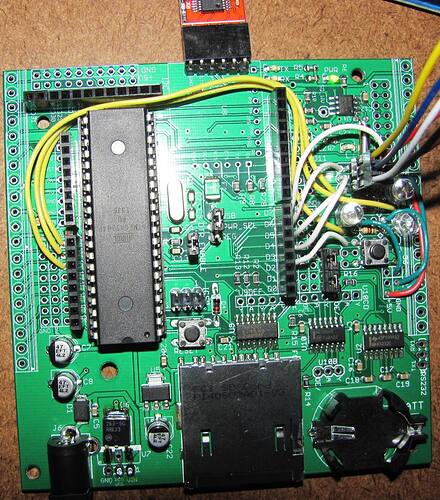

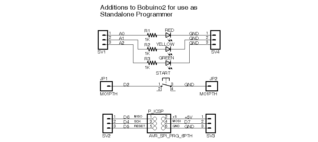

I made these additions to a Bobuino2 (1284P), double checked wiring with a meter, wrote some test codes & tested that D4,5,6,7,A0,A1, A2 all toggled a test LED and the correct signal LED when a button on D2 was pressed.
Confirmed programming header is wired up:
MISO D6 +5
SCK D4 MOSI D7
Reset D5 Gnd
Downloaded the 1.25a code from here
I don't have a memory card inserted yet, because I can't find the folder
C:\Users\CROSSR~1.CRO\AppData\Local\Temp\build3718148874247167592.tmp\filename.cpp.hex
to grab the blink file saved as filename.ino & compiled for a test which is pretty aggravating by itself.
When I power up, the L led turns off, and I get 5 Red flashes. I'm connected to a working Uno card.
Any ideas what to pursue here?

Do I need a 1284p section here?
I did tell you I only planned to use this from a '328P, but this is the only way I have to access an SD card at the moment so I figured I'd give it a shot before I ordered custom '328P cards which I just finished cleaning up yesterday.
With Bobuino:
PB0 = D4
PB1 = D5
PB2 = D6
PB3 = D7
PB4 = D10, SD CS
PB5 = D11, MOSI
PB6 = D12, MISO
PB7 = D13, SCK
5 slow flashes? Like, a second apart?
So it can't open the SD card?
I don't have a memory card inserted yet, because I can't find the folder ...
Put the card in anyway, see if it changes to some other flash rate.
Also, for debugging, run the hex uploader sketch (the one that writes to the serial port). The messages there might make it easier to see what is going on.
Yes, 5 flashes about 1 second apart. L light flicks on really fast between the 5 flashes.
Does the same with blank SD card.
