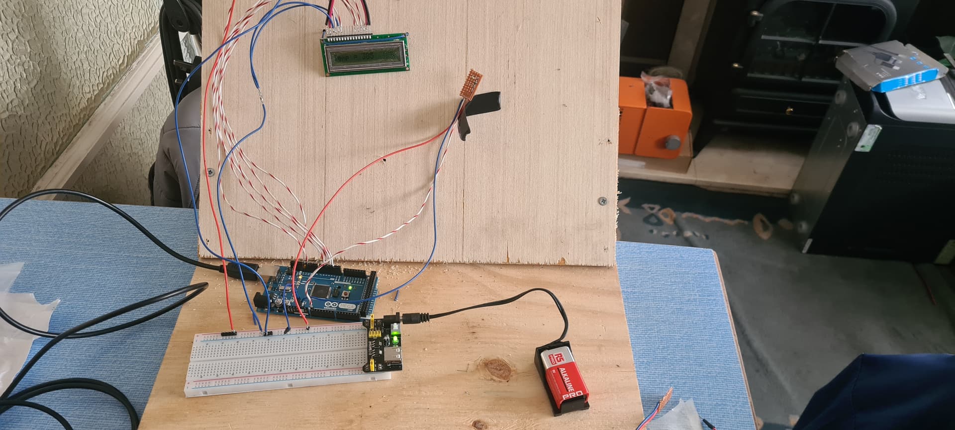

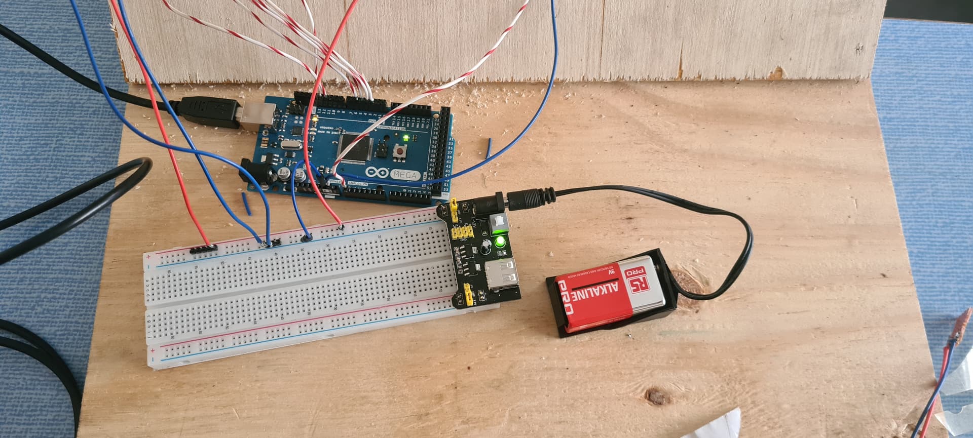

Its a very basic circuit, hence reason not drawn it up, its basically the same from the other day.
Except the one one board is usb powered the other 5v powered from a 9v battery.
So will link the grounds together tomorrow and try again.

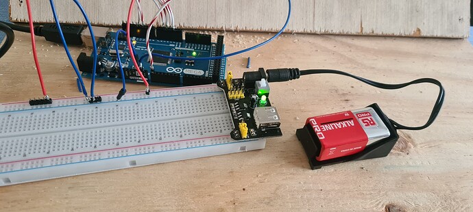

I don't like the sound of that at all from the point of view of the current capacity of the battery if it is a PP3 type as illustrated in post #148

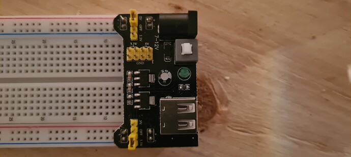

It is but not directly powered...
9v battery powers this module to provide 5v & 3.3v
Using a PP3 to power the breadboard power supply makes things worse if anything

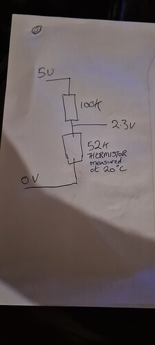

Can you measure 5V there?
What are these 2 wires for?
I'm not really an electronics engineer but looking at the voltage divider, can it be that the impedance of your circuit is too high?

So how can i power things
Those two wires went off to a 10k pot, removed after photo was taken as was checking pin spacing
Oh - didnt spot that earlier
Thanks
A 5V 'phone charger would be a good start
Ok, just thought the 9v would have less noise produced

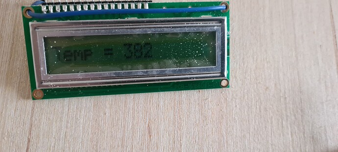

I can usb power the second board from a phone charger, i got a spare one lying about, so just use common the ground ground?
A battery will have less noise (none) but if it can't supply the required current at the required voltage then noise is not going to make any difference

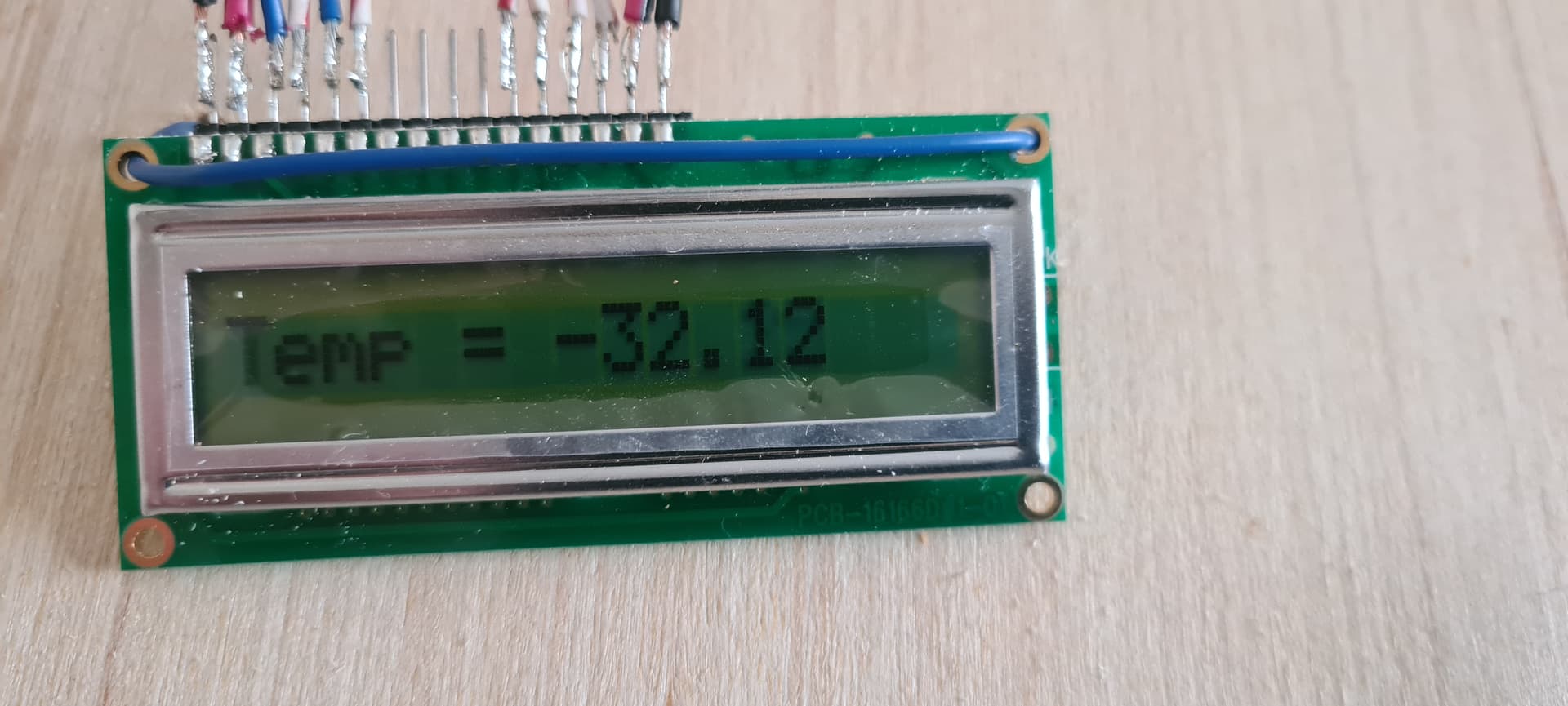

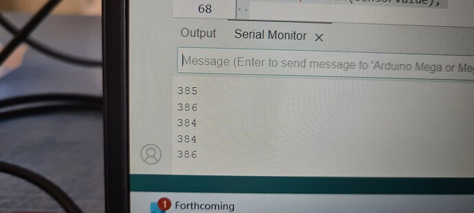

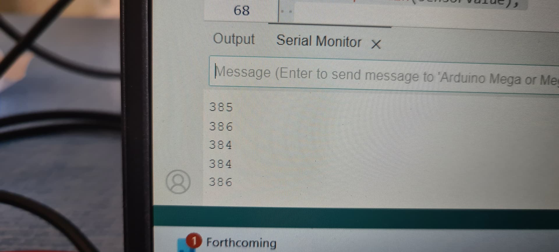

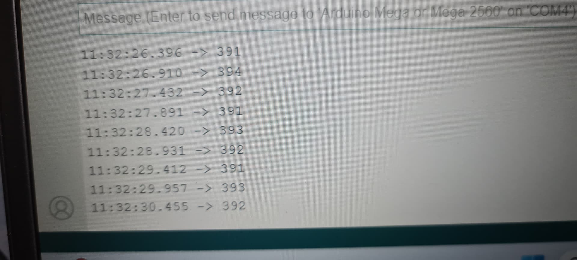

whilst i resolve the issue and find the correct USB lead to power the unit, linked the ground out from one board to the other and resolved the issue - the LCD and Serial Monitor are now displaying the same reading 374 - with 1.154vdc on the input pin A0 but the display is saying 1.83vdc (5/1023x374)
Ok rooky error not common ground between units. So more stable
Great. Now change back to lcd.print(T); to display the temp
  lcd.print("Temp = ");
  // lcd.print(T);
  lcd.print(Vo);   // Changed to display input on Analogue Input Pin A0
  Serial.println(sensorValue);

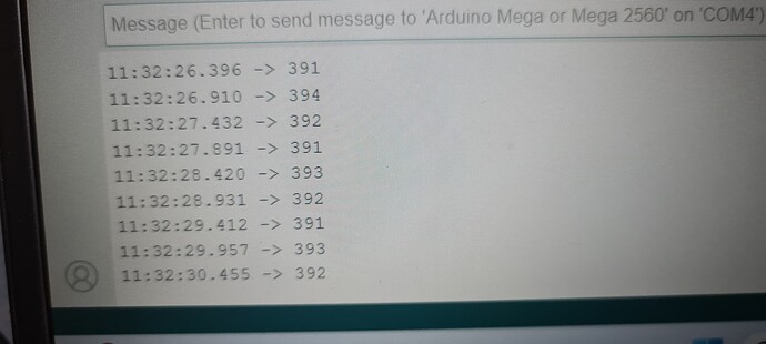

So we got something wrong as we have a negative value -31.98 with Serial Monitor saying 392...
But some progress is better than no progress.
So this must be a maths issue now

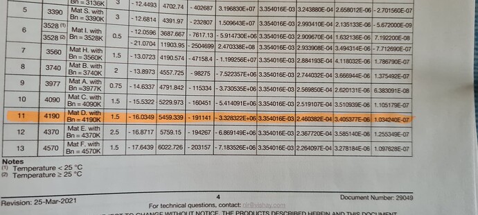

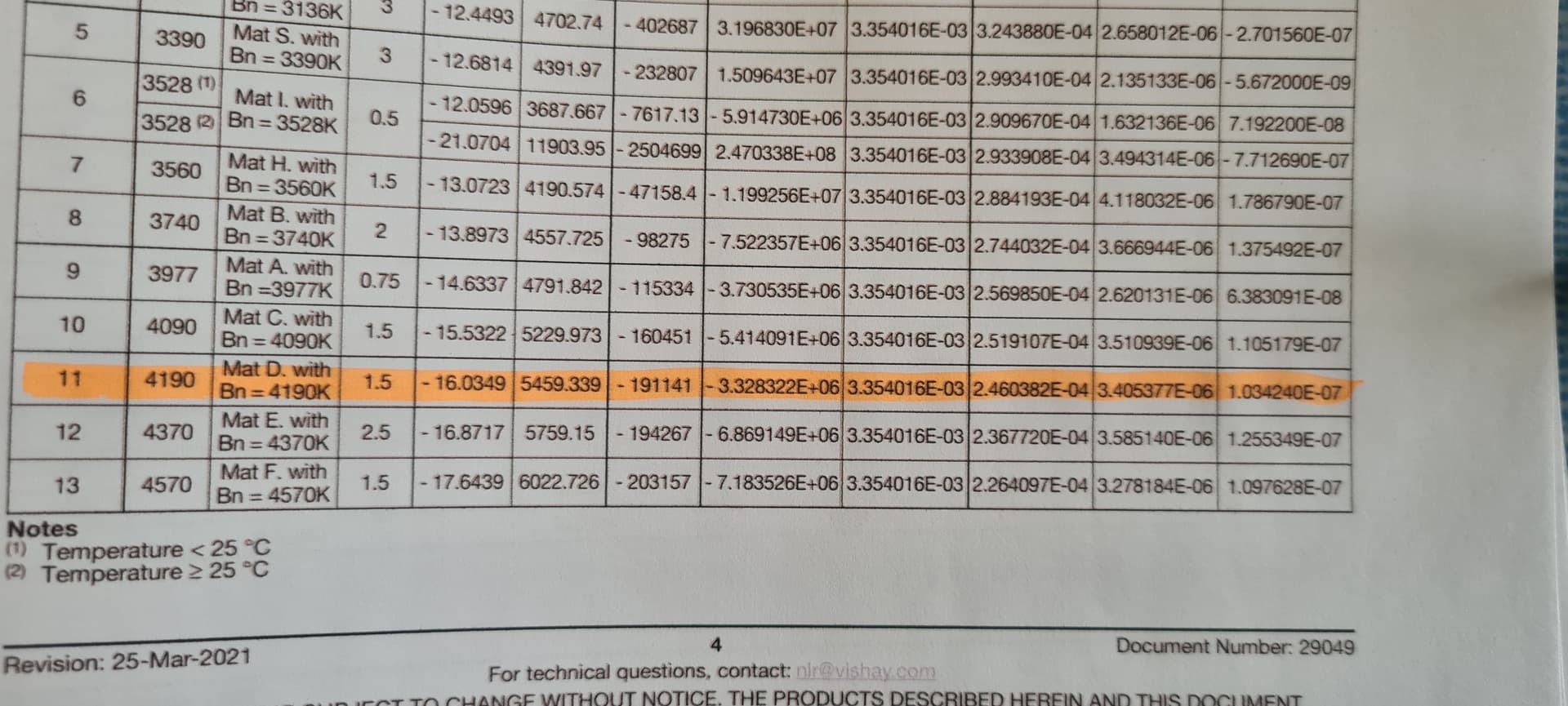

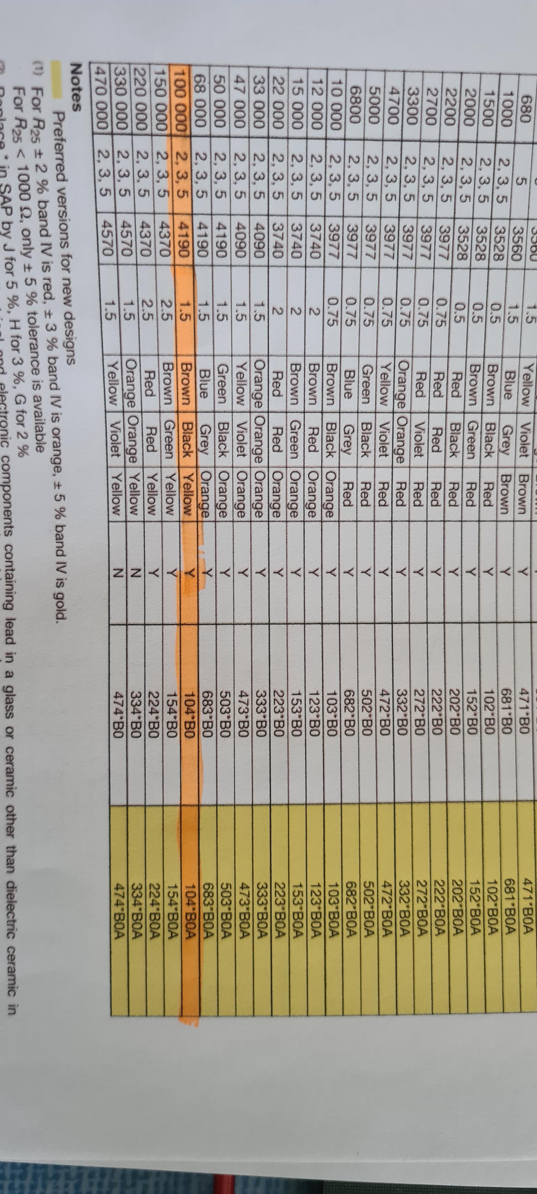

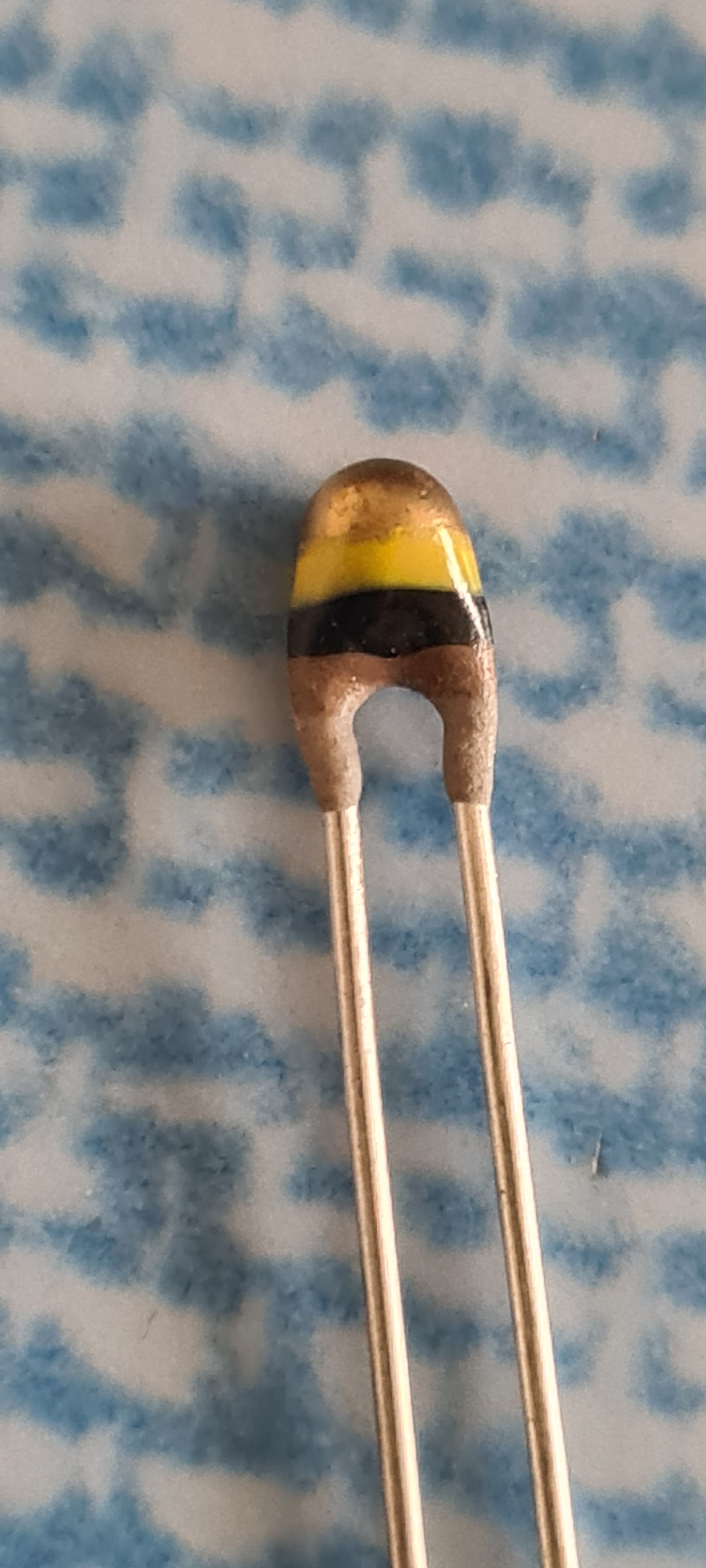

Where did you get the formula?
  T = (1.0 / (c1 + c2*logR2 + c3*logR2*logR2*logR2));
FOUND IT
Your coefficients need to come from the table on page 4
OK well i cocked that up, now got a negative value -311.70
 16x1 LCD display using hd44780.h (Hitachi HD44780 driver).

float c1 = 3.354016e-03, c2 = 2.460382e-04, c3 = 3.405377e-06; // 100K NTCLE100E3 Vishay Thermistor A1, B1 & C1 values

Try K-1(B1) K-2(C1) K-3(D1) values. I'm grasping now
