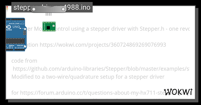

See also this simulation using the Arduino Stepper.h library driving a STEP+DIR driver with its two-wire quadrature constructor: Stepper myStepper(stepsPerRevolution, 8, 7);
 Stepper Motor Control using a stepper driver with Stepper.h - one revolution
Simulation https://wokwi.com/projects/360724869269076993
code from
 https://github.com/arduino-libraries/Stepper/blob/master/examples/stepper_oneRevolution/stepper_oneRevolution.ino
Modified to a two-wire/quadrature setup for a stepper driver
for https://forum.arduino.cc/t/questions-about-my-hx711-stepper-project/1102568/29
and https://github.com/arduino-libraries/Stepper/issues/40
 This program drives a stepper motor using a driver.
 The motor driver STEP input is attached to digital pin 8 of the Arduino.
 The motor driver DIR is attached to digitalPin 7
 The digital pin 9 is attached to a DIR status led.
 The motor should revolve one revolution in one direction, then
 one revolution in the other direction.
 Created 11 Mar. 2007
 Modified 30 Nov. 2009
 by Tom Igoe
 Modified 2023-03-31 by drf5n
#include <Stepper.h>
const int stepsPerRevolution = 200*4;  // change this to fit the number of steps per revolution
// for your motor.  The *4 factor is due to the 4 steps/cycle change in the
// Stepper.h two-wire quadrature output setup
// note that the DIR pin toggles in step with the STEP pin, but
// with the level HIGH or LOW depending on direction
//This scheme works per the table at
// https://github.com/arduino-libraries/Stepper/blob/master/src/Stepper.h#L64-L72
/*  The sequence of control signals for 2 control wires is as follows
 * (columns C1 and C2 from above):
 * Step C0 C1
 *    1  0  1
 *    2  1  1
 *    3  1  0
 *    4  0  0
 * If C0 = STEP, and C1 = DIR
 * and the step 2 is the leading edge of STEP, then DIR is high
 * and in the opposite direction, if 3 is the leading edge of STEP,
 * then DIR is low.
// Per https://forum.arduino.cc/t/change-stepper-dir-according-to-predifined-analog-input-value/1118716/25
// and
// initialize the Stepper library on pins 8 through 11:
//Stepper myStepper(stepsPerRevolution, 8, 9, 10, 11);
// Use 1 pin as STEP and other for DIR
const int dirPin = 7;
  // set the speed at 60 rpm:
  myStepper.setSpeed(60);
  // initialize the serial port:
  // step one revolution in one direction:
  Serial.println("clockwise");
  myStepper.step(stepsPerRevolution);
  // step one revolution in the other direction:
  Serial.println("counterclockwise");
  myStepper.step(-stepsPerRevolution);

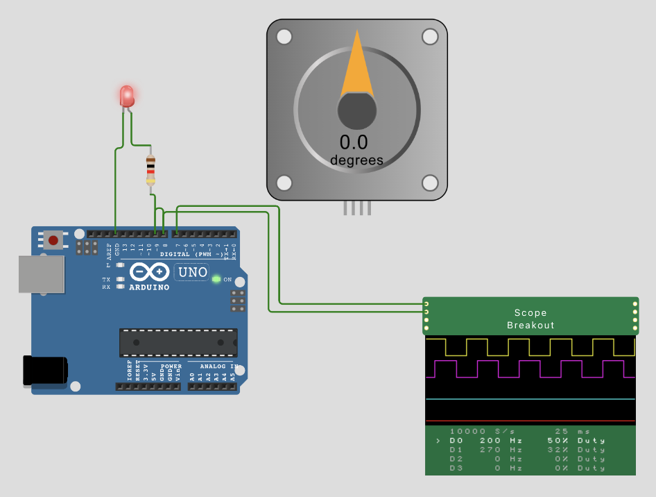

That is not a quadrature signal, they are either in phase or 180° out of phase. Quadrature signals are 90° out of phase.
Is too:
Read the vertical axis of the table as time:
Plot the outputs of pins 7 & 8 on Serial monitor and compare to your scope display. The driver is creating the quadrature signal.
How about I remove the driver completely and hook the scope to 7&8:
Proceed forthwith. :grin:

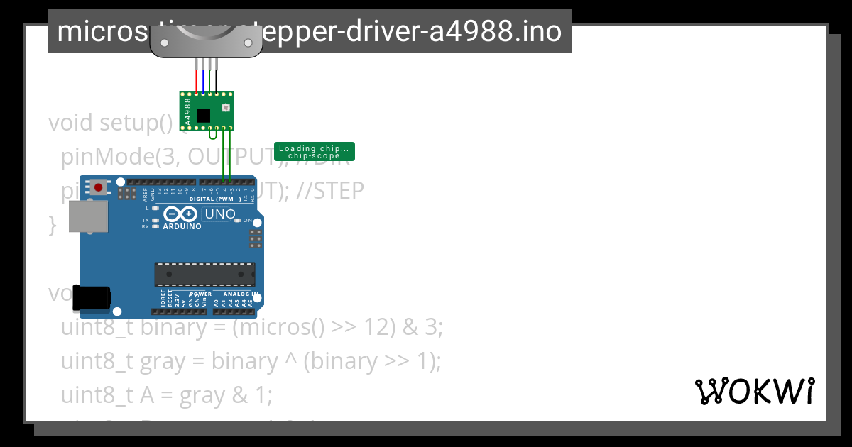

Other: micros() to Gray Code conversion.
Now if I could just find a way to go back in time :stopwatch:
Maybe invert B when you want to go back in time?
  pinMode(3, OUTPUT); //DIR
  pinMode(4, OUTPUT); //STEP
  uint8_t binary = (micros() >> 12) & 3;
  uint8_t gray = binary ^ (binary >> 1);
  uint8_t A = gray & 1;
  uint8_t B = gray >> 1 & 1;
  digitalWrite(3, A);
  digitalWrite(4, ((micros() >> 22) ^B ) & 1);
Oh, I meant literally, like a time machine. :grin:
Inverting B is much easier than swapping the STEP / DIR connections or pins 3 and 4 in code.

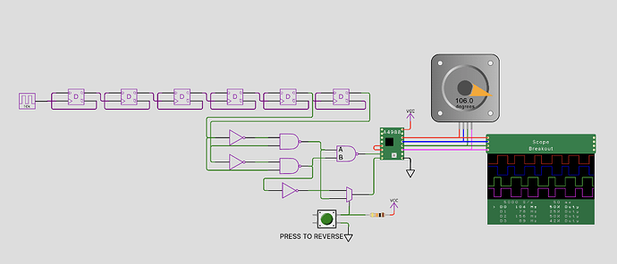

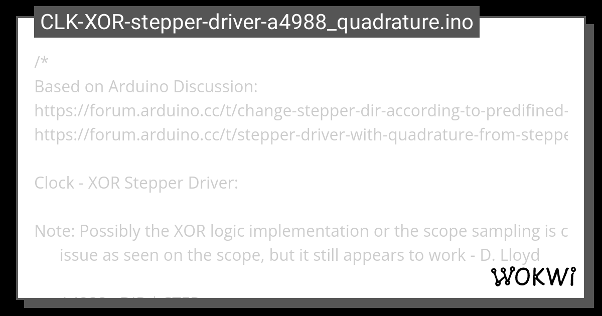

Here's how it works with discrete logic and a scope:
Thanks @dlloyd
