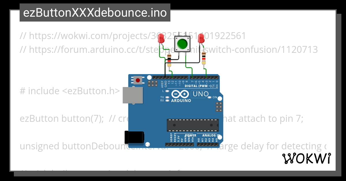

Here's a comparison of debounce schemes:
// https://wokwi.com/projects/363256151401922561
// https://forum.arduino.cc/t/stepper-limit-switch-confusion/1120713
# include <ezButton.h>
ezButton button(7);  // create ezButton object that attach to pin 7;
unsigned buttonDebounceInterval = 2000;  // large delay for detecting differences
// stick-built responsive debounce infrastructure
static unsigned long buttonStateChangeTime = -buttonDebounceInterval; // negative to induce rollover
static uint8_t buttonState = HIGH;
  button.setDebounceTime(buttonDebounceInterval);
  pinMode(12,OUTPUT);
  pinMode(3,OUTPUT);
  button.loop(); // MUST call the loop() function first
  // Responsive debounce change detection
  uint8_t buttonTransient = digitalRead(7);
  if (buttonTransient != buttonState && millis() - buttonStateChangeTime >= buttonDebounceInterval) {
    buttonStateChangeTime = millis();
    buttonState = buttonTransient;
    Serial.print("Responsive button changed to ");
    if (buttonState == HIGH) { // rising edge
      Serial.println("UP");
      digitalWrite(3,LOW);
    } else { // falling edge
      Serial.println("DOWN");
      digitalWrite(3,HIGH);
  if (button.isPressed()){
    Serial.println("The button is pressed");
    digitalWrite(12,HIGH);
  if (button.isReleased()){
    Serial.println("The button is released");
    digitalWrite(12,LOW);
  static unsigned long last;
  if (millis() - last > 777) {
    last = millis();
    Serial.print("the button is ");
    if (button.getState())
