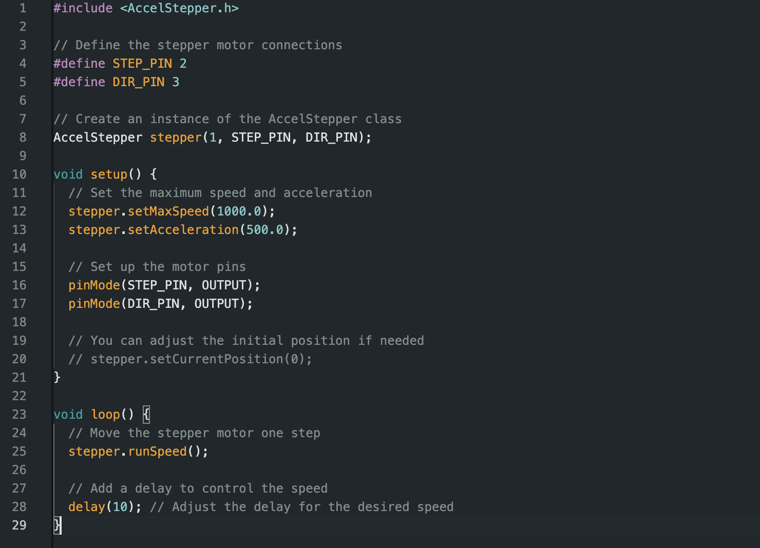

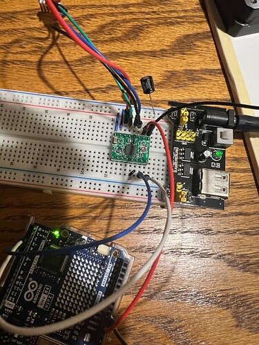

I am so incredibly new to Arduino and breadboard circuits and I want to use my Arduino Uno to control a stepper motor. I have the following sketch and setup, but whenever I hit upload to Arduino, nothing happens. I'm sure I'm just overlooking something super simple, but was hoping to have another set of eyes catch it for me...

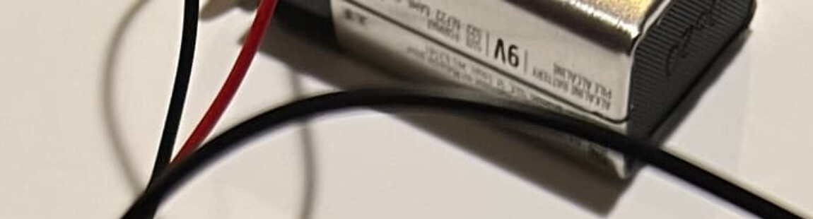

- You cannot power a Stepper Motor from a 9v PP3 battery.
- Those solderless breadboard power supply modules are not meant for high current loads.

You cannot power a stepper motor from a 9volt PP3 battery (LarryD).
And you cannot power Vmot of a A4988 stepper driver with less than 8volt.
(the breadboard supply is set to 3.3volt).
Vmot of the A4988 should be 12volt, or even 24volt, regardless of stepper motor voltage.
Post a link to the stepper motor used.
Leo..
Your first attempt has several problems, some of which have already been addressed in previous posts.
Where did you get the sketch and setup from? I don't think the person who wrote this sketch knows much, if anything, about the AccelStepper library.
And don't post sketches as images - see advice from @TomGeorge

keep your stepper-driver A4988 alive:
Another thing that is important is:
Never connect / disconnect the motorwires when the power-supply is switched on.
You know these electric fences that give you an electric shock if you touch them?
The same thing happends to the step-motor-driver A4988 if you connect /disconnect the motorwires with power switched on.
The motorcoils are inductive loads and create high voltage spikes (just like these electric fences) if you disconnect a motorwire. This can destroy the A4988.

use MobaTools instead of AccelStepper:
I recommend that you use the MobaTools-library instead of accelStepper.
Using the MobaTools will save you a lot of trouble if you go beyond a simple loop that just does rotate the stepper-motor.
With accelstepper you create either blocking code
or
your loop must always run very fast fast enough to create the next step-pulse at the right time.
The MobaTools avoid these problems through creating the step-pulses in the background.
This enables that your code can do other things in "parallel" to the step-pulse creation.
