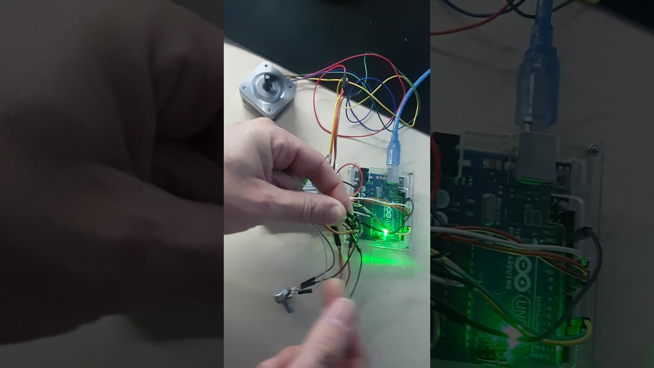

This is my last version of code, and an image with my setup.
![](http://c:\Users\VirtualPax\Downloads\WhatsApp Image 2020-03-22 at 18.11.19.jpg)
Thanks for the pic.
Tom... :slight_smile:
so... can someone help me with what i should write in my code to make it run as it should?
Why do you have an extra set of {} in the void setup() , highlighted in RED?

Remove those brackets and see what you code runs like then.

@6v6gt since i am new to arduino and i don't know what i am doing, can you PLEASE implement that in my code? I have no idea where i should put the code you sent me, how to declare things and what to keep or discard from my code. I would appreciate a lot if you could do that for me
i modified the library for the LCD ( #include <hd44780.h> ). i heard that this one is "faster"
@TomGeorge i made the modifications you suggested, but with no success

OK. I can put something together for you. I just want to make sure before I start that the code that you last posted (with all the LCD statements commented out) does work in that the motor can go clockwise, anticlockwise at various speeds and also stop. Also, I can't test it so any troubleshooting could get complicated but we can try.
this is the last version of my code that somewhat works. It works perfectly untill i uncomment from the loop the "lcd1.setCursor" and "lcd1.print" commands. When those commands are activated, the potentiometer does not seem to work and the stepper motor spins extremely slow.
Another problem i noticed just now is that the potentiometer values are inverted on the lcd screen( if the pot is at max, on the lcd is at min)

This should work at least like the old one did. I have not tested it with a stepper motor but the rest appears to work. If you have problems with the stepper motor, describe carefully what you see.

i uploaded the code into my arduino board. The motor speed is PERFECT, but the potentiometer does not work, the display is frozen and the motor does not switch direction nor stop. Here is a link with a short video i made:
