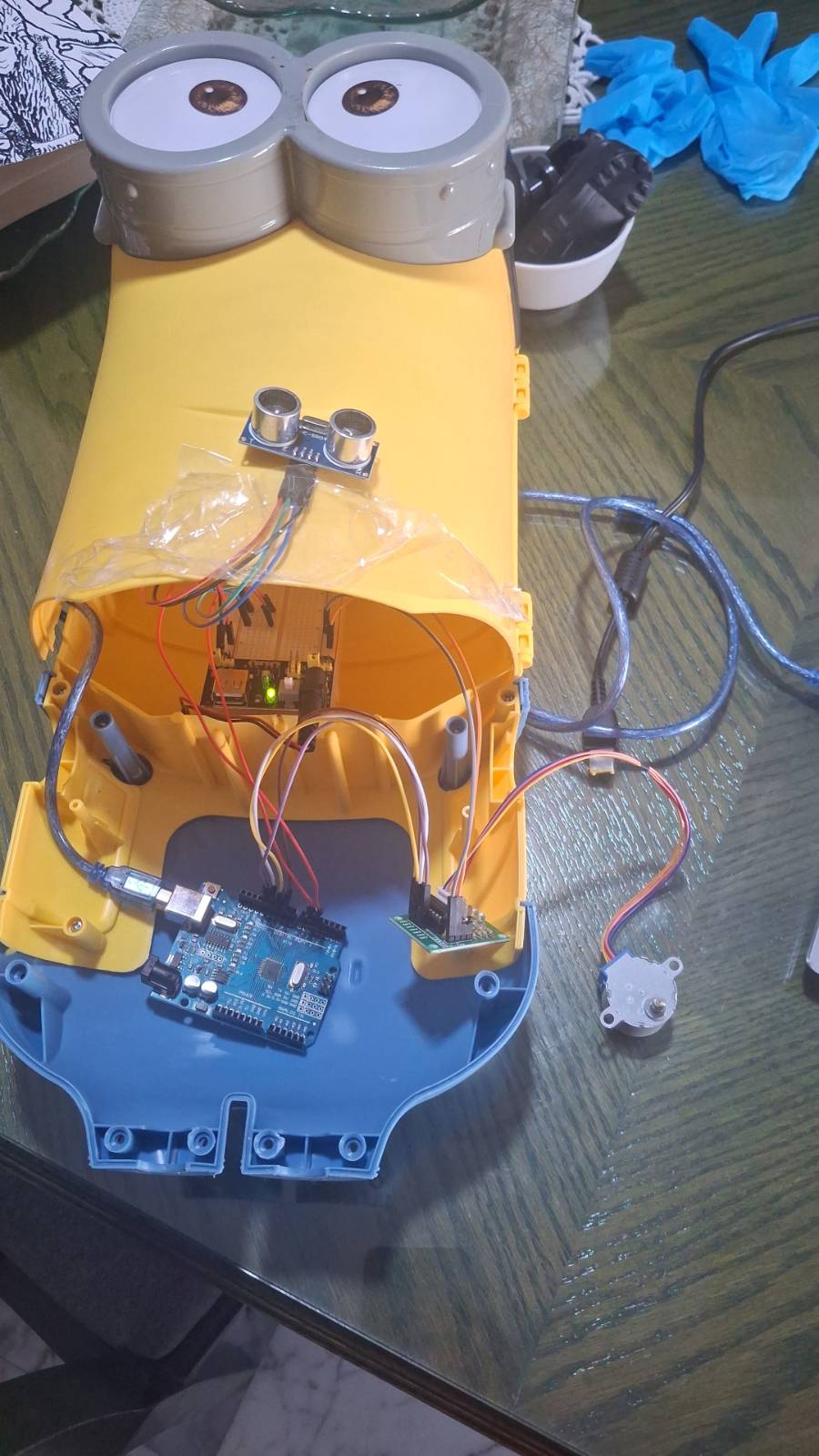

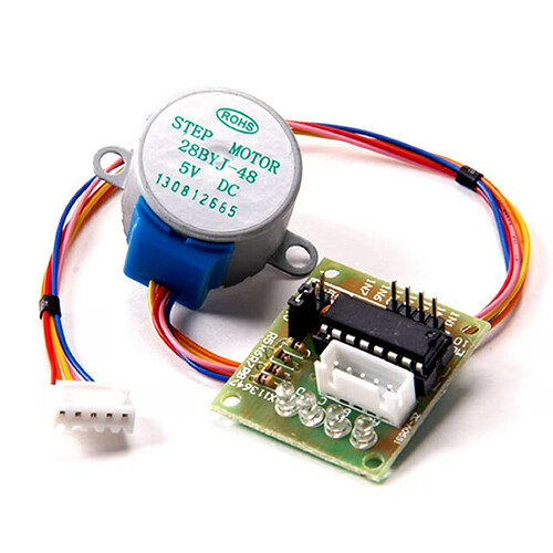

Hello, I'm currently repurposing my old kevin the minnion toy by disecting it and inserting an Arduino R3 UNO, a HC-SR04 ultrasonic sensor for avoiding obstacles, a ULN2003 Motor Driver Board and a 28BYJ-48 Stepper Motor to control side wheel one, a Breadbord power supply model connected to a 9v battery connecter transmitting power to the module via a 9v battery, a servo motor to control side wheel 2, and lastly a 3v DC motor in the back for stability. Honestly, I think this is a suitable beginner project to get me used to doing big projects without following any 1 specific video guide, but I'm open to listening if you disagree.
Till now, I have disected Kevin, connected the ultrasonic sensor, power supply module, 9v battery, 9v battery connecter, arduino, Motor Driver Board, and the stepper motor all together and managed to combine two different .ino files from github to make the code you can see below.
My issue here is that the stepper motor will not rotate even though they are no errors whatsoever. I tripled checked the pins and they are correctly arranged and what makes it even more weird is that the ultrasonic sensor is doing exactly what it needs to.
If you have any other concerns such as questioning if I can do it, giving me tips on what to use etc, feel free to post them I am very open to listening and I truly welcome it as I am new to engineering. Here are my components:

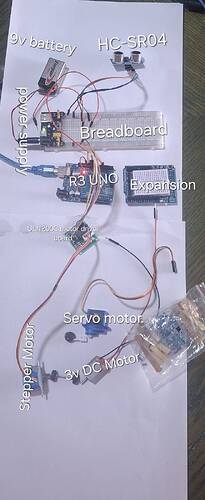

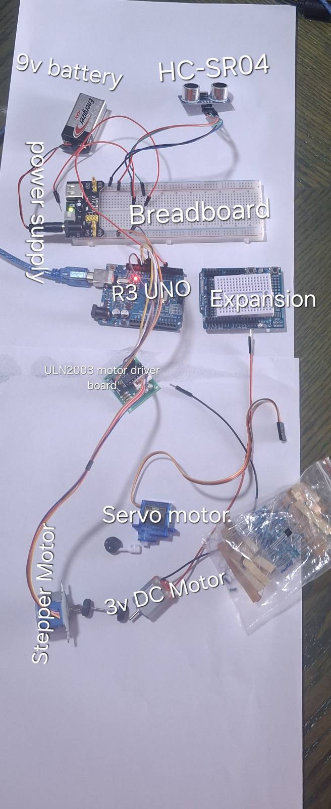

A schematic at this stage would be most welcome.
Do you have a DMM? Digital MultiMeter?
What's this?
Hello Tom, beforehand, I want to thank you for your fast and welcoming response, I really appreciate it.
Now, I suck at drawing and I'm not an actual engineering student. I'm still in school, so I neither can draw the universally recognized symbols nor can I draw understandable circuits in general, so I'm going to make a (kinda) life sized version using two a4 papers and place the actual equipment on it.
(wheels are sample)

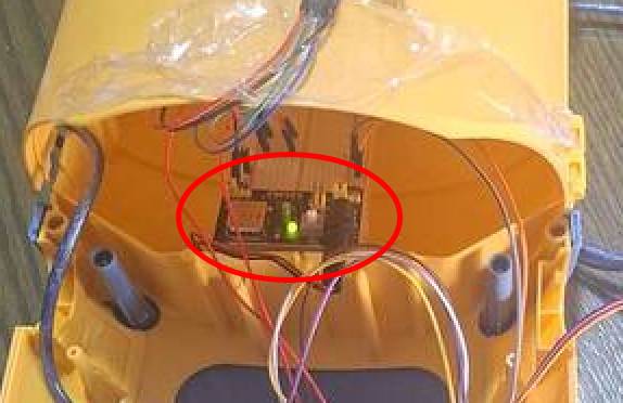

I am using the 9v power supply for stuff that don't truly require the arduino and / or are kinda dangerous long term and can cause damage
I have heard of a multimere and I do plan to get it, but not a DMM. From the fact that I haven't heard of it, I don't think so.
I learned the same guy that I got the code from so I will just do the same thing as you see from the code and we know that right now it isn't working, so what's the point really?
Thank you
Power supply module
here's the full cicuit:

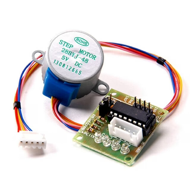

Do the LEDs on the driver flash in sequence?
flashes as C-B-A indivisually
are you powering the 5V stepper motor with the 9V battery?
Try 4 AAs
Should go in sequence A-B-C-D or D-C-B-A
Try removing the motor from the board and try again.
I'm powering it through the bread board power supply module which takes from the 9v battery but gives 5v and 3.3v.
I also don't have AAs rn
Still going C-B-A
Something not right. Check your wiring
it's not just voltage. the 9V battery may not be able to supply sufficient current.
Try this code. It should flash all the LEDs slowly in sequence.
If not, then you have a wiring error or maybe the ULN2003 board is bad.

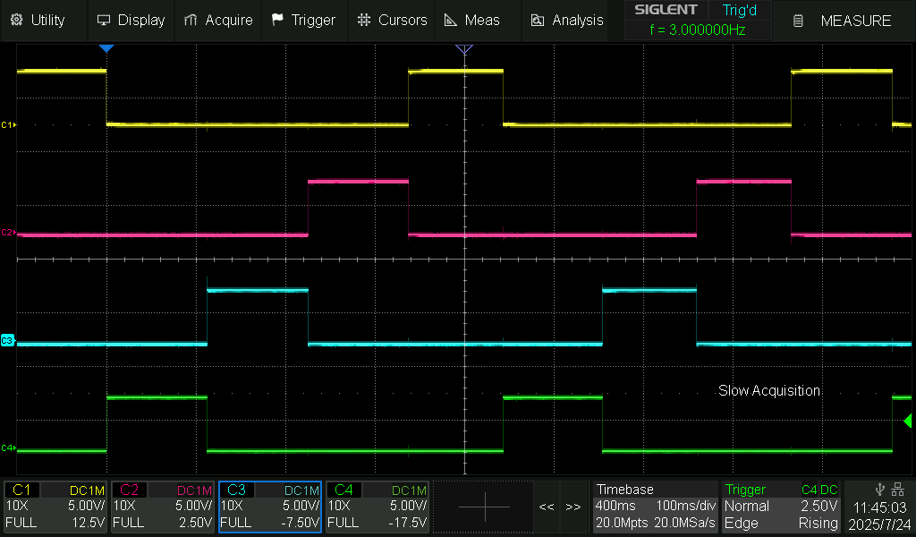

with OneStep(false); as in the code posted, the sequence is D-C-B-A.
Changing to OneStep(true); gives the sequence A-B-C-D.
Note that the pulse width is determined by the time it takes to go round loop( ).
This varies depending on the time it takes for the HC-SR04 to receive an echo.
Hence the stepper motor will speed up (slightly) as it approaches an obstacle.
