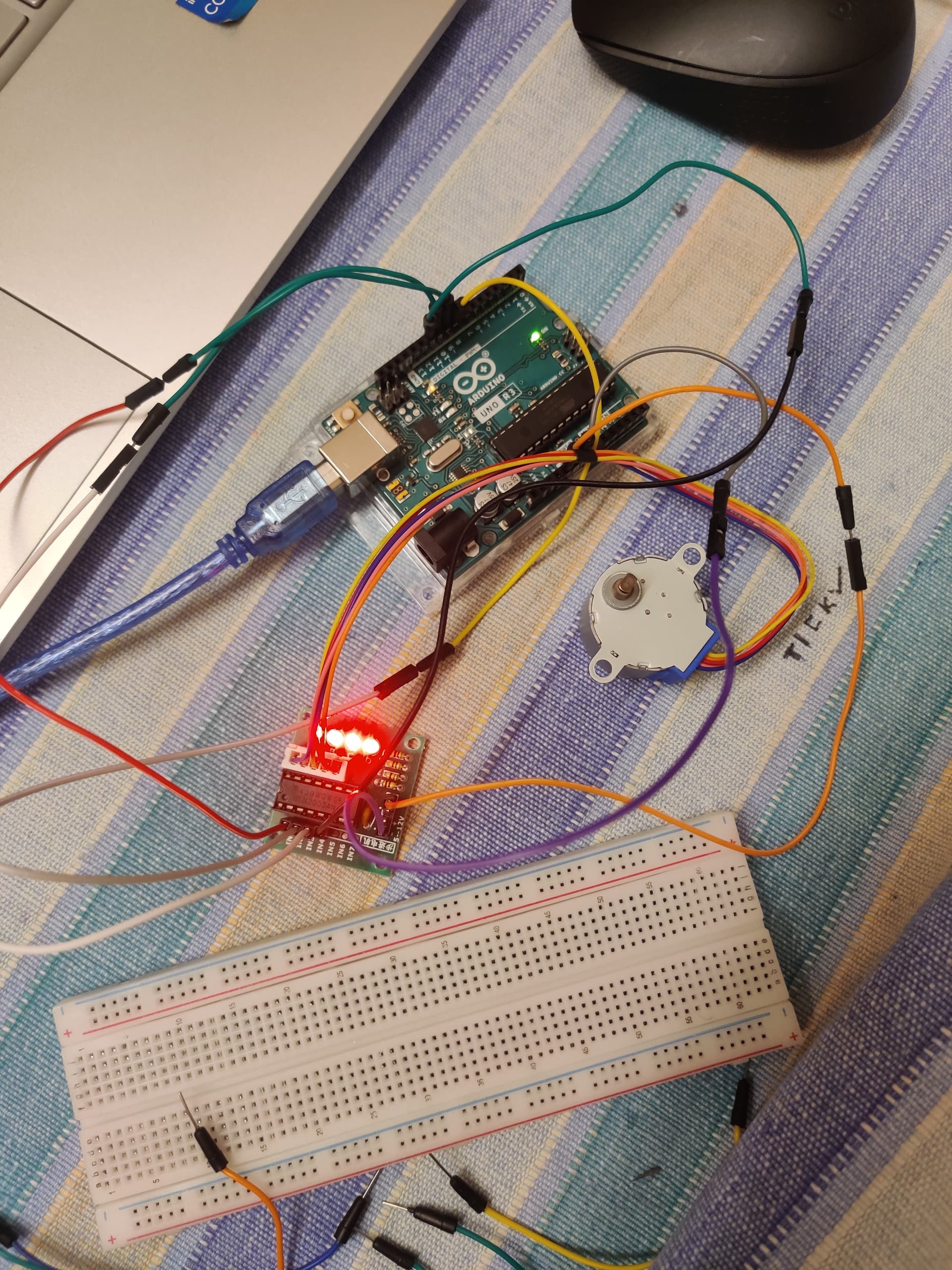

My stepper motor is not turning counterclockwise. When it tries to turn it just goes on in one direction.

Try using the stepper library correctly, and change the direction of rotation instead.
myStepper.step (-stepsPerRevolution);
changed still not working
Sorry, I was thinking of a different stepper library. That should have worked, so check the motor wiring for continuity. Perhaps one coil is not properly connected, or the wire order is not correct. On those motors, the wire colors vary between manufacturers.

All the pins are connected correctly like pin IN1 to pin 8, IN2 to 9, IN3 to 10 and IN4 to 11.
Does the ULN2003 have soldered pins (or sockets) or are the wire pins (or sockets) just placed in a hole?
As in ??

Do the LEDs on the driver board blink when it tries to go backwards?
That may not be correct. See this whole thread:
If the problem is that the coils are crossed, perhaps swapping the middle two wires in code would uncross them:
Stepper myStepper (stepsPerRevolution, 8,10,9,11);

That's not correct. You must swap pin 9 and 10. Either in HW or in this line:

Try:
Yes they blink
