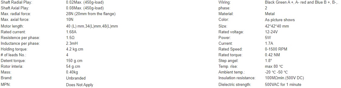

I did not find the exact datasheet for my motors, so i posted the specifications from the shop.
