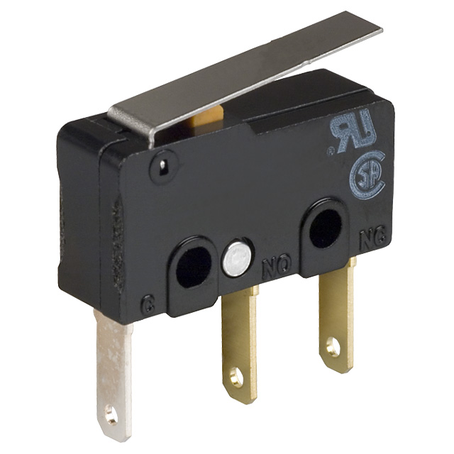

is there something moving connected to the motor (i would assume so)? typically you would use a limit switch and turn your motor in one direction until that switch gets activated by your mobile part hitting the switch. then you know where you are, at a reference point and you can count steps to the "home" position

Look for limit switch onyour favorite store - they look somewhat like this with a contact switch that might be different based on the needs of your moving platform
