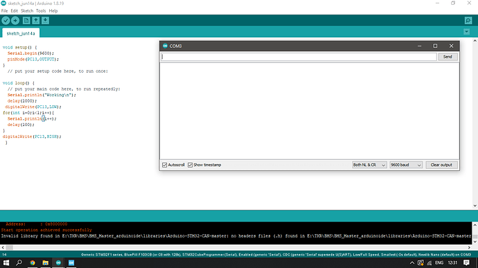

Hello, I am new to the community and to the project I am working on.. I am using a STM32 blue pill board and programming it with a simple code of serial communication :
Serial1.begin(9600);
pinMode(PC13,OUTPUT);
Serial1.println("Working\n");
digitalWrite(PC13,LOW);
for(int i=0;i<2;i++){
Serial1.println(i++);
delay(100);
digitalWrite(PC13,HIGH);
I am using stm32103c8t6 blue pill board
with generic Stm32f1 series
my doubts :
  1. I previously uploaded a code with memory size >64 kb on the blue pill and it worked and after 10-15 cycles of uploading, the physical board was not working even after i upload the code correctly even with less size.
  2. Now i am using a different stm32blue pill board , but it is having this issue : when I increase the value of i in my code to 2 and after, serial.print suddenly stops working..not even the "working" string is getting printed.
  3. I tried erasing the memory of both boards using stmcube programmer, tried changing board variant to generic stm32f1x, nothing productive has happened yet.
    can someone please direct me on this ? its very crucial for my project..

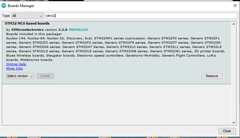

You must provide some more information. There are at least two different board-manager packages to program the stm32. Which one do you use?
And there are different possibilities to connect the blue pill to the PC. Did you use the native USB-connection?
@MicroBahner
  1. I am using Arduino STM32 core provided by STM32duino
    https://github.com/stm32duino/BoardManagerFiles/raw/main/package_stmicroelectronics_index.json
  2. I am using FTDI to program the board
What happens if, after loading your sketch, that you disconnect the USB cable from the FTDI device and connect a USB cable between the Bluepill's USB socket and your PC ?
Under tools --> port, do you see other devices apart from COM3 ?

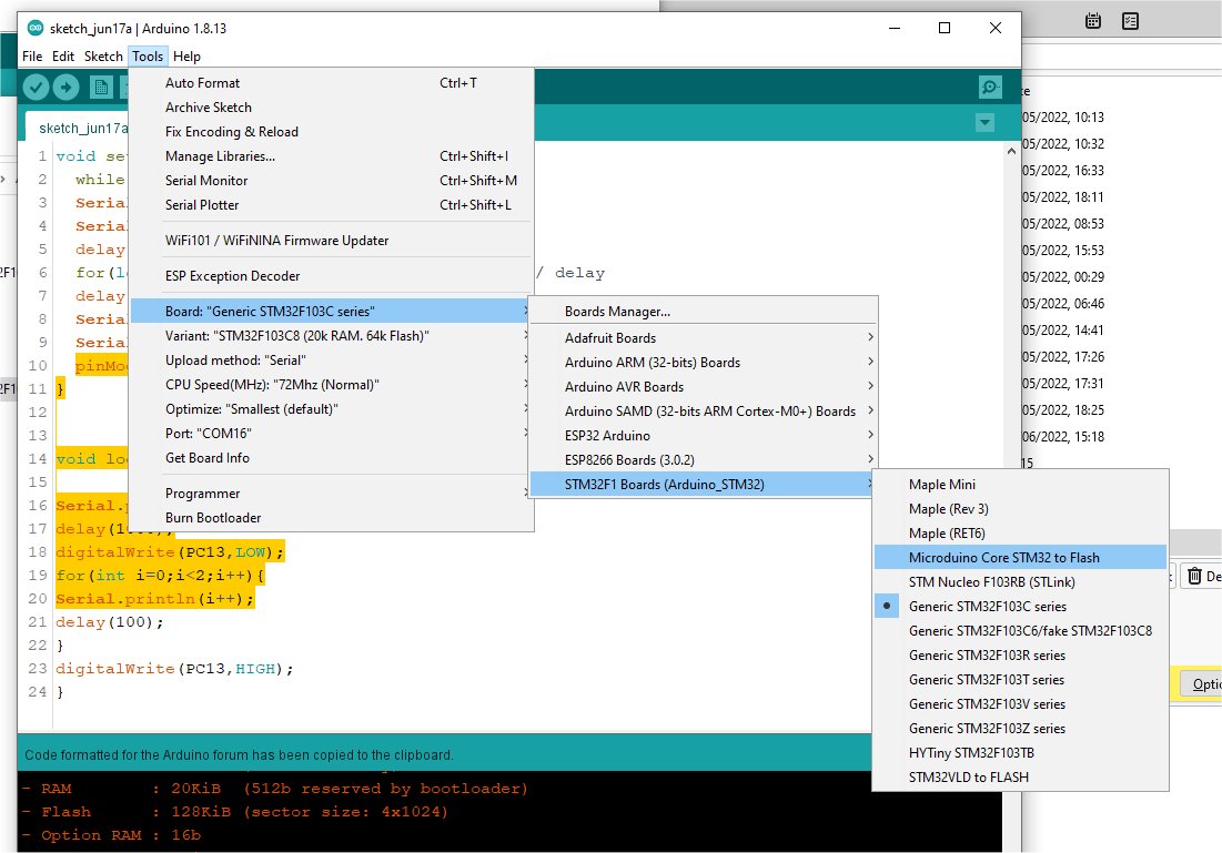

This is how I configure a Bluepill to use its USB socket to attach the serial console. It may give you another com port:
This is the STM32 core I am using:
this is the one
http://dan.drown.org/stm32duino/package_STM32duino_index.json
I got it from Getting-Started-With-Stm32-Using-Arduino-IDE plus the connection to the FTDI board
@horace I tried doing exactly what you were.....I am am the point of breakdown sigh nothings working for past few days....both of my stm blue pills blink with a random delay and nothing goes on serial monitor....is stm32duino really a thing ?
@6v6gt are you getting the data on serial monitor using USB ?
Yes, using a direct cable connection between the Bluepill and the PC but:
  1. I use this option for the Bluepill type:
  2. COM3 on my PC is defined but used for an Intel Service. Check that the serial monitor is looking at the right com port:
    COM17 here is for the Bluepill.
  3. I am using Serial, not Serial1

This is the old "Roger Clark" STM32 core.
The OP is using the official STMicroelectronics core > 2.0.0 from this URL https://github.com/stm32duino/BoardManagerFiles/raw/main/package_stmicroelectronics_index.json
