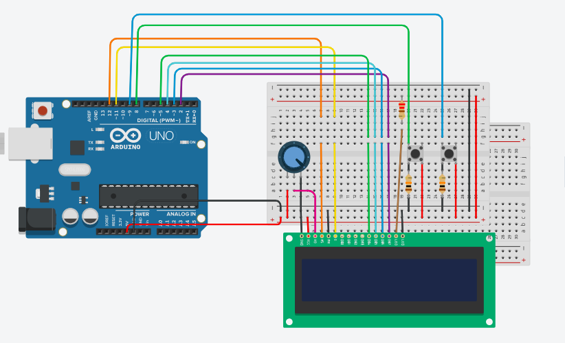

I'm new here and would like to get some help debugging my code. This stopwatch should stop when PB is pressed and released, and then start again when pressed and released.
Thank you in advance.
Please help debug this code: Arduino stopwatch using pushbutton. It should start when pressing pushbutton and stop again when pushbutton is pressed.

What does it do at the moment ?
Have you tried adding some Serial.print()s to show which sections of code are running and the value of pertinent variables at that time ?
How is the input wired ?
Do you have pull up or pull down resistors in place or is the input floating at an unknown voltage ?
My mistake. Well it starts with a screen "Stop! 00:00". I need it to start with "Run! 00:00" and then counting. Also, when PB is pressed it need to stop and displays "STOP" and then when is pressed again it needs to start over "Run! 00:00".
I hope this helps. Thank you!
Where in teh code does it display "Run!"
And the answers to the other questions ?

Thanks for letting me know. Code was edited. I'm also attaching my circuit.
I found my error so thanks for the help and for your code.

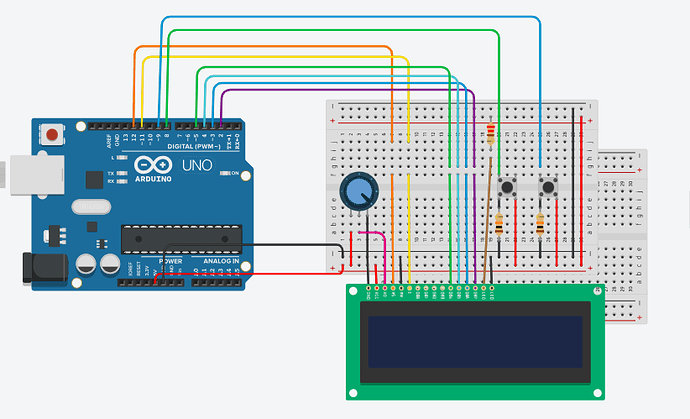

ok. Now I need to add a second PB. PB1 needs to start the count and PB2 stops the count. My problem is that it only starts counting when I press down PB1. PB2 does stop the count. However I need to press PB1 and start the count without holding it down. Thanks
You need to detect when PB1 becomes pressed not when it is pressed. Look at the StateChangeDetection example in the IDE
