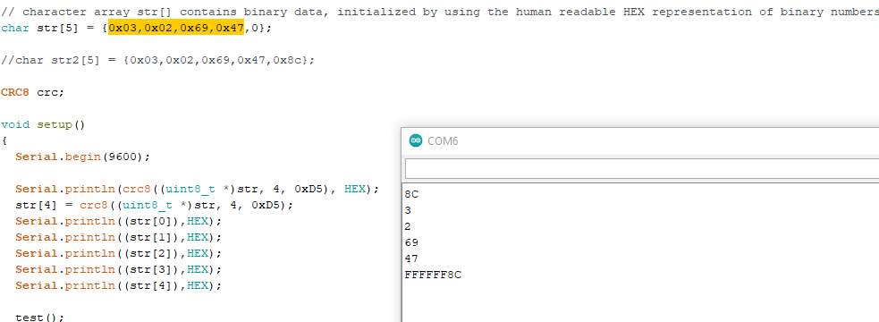

I ran the code you provided str[4] = crc8((uint8_t *)str, 4, 0xD5); with the declared str[] of length 5. When you put str[4], is it because the stored value goes from 0 to 4 right?
I tried serial printing the character array at position 4 using Serial.println(str[4]); to check whether I would see the binary CRC value but a strange character appear instead (⸮), tried serial printing the whole character array Serial.println(str); and I get:

You need to learn more about arrays. If you declare str[5], then array indices 0 to 4 address the five binary values stored in str[0..4].
To print the binary value stored in str[4] in human readable hexadecimal format, use
Serial.println(str[4], HEX);
Why are there F's before 8C?
Thanks a lot
Bug in Serial.print(). Get around it with
Serial.println( (0xFF & str[4]), HEX);

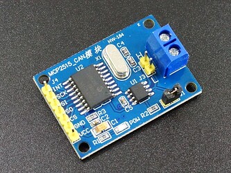

Using two MCP2515 CAN Bus Interface Modules, and the <SPI.h> and <mcp2515.h> libraries.
This is my current set-up:
The context is I want to transmit a GPS coordinate value from one CAN bus module to the other one, this coordinate is in the format of a number, for example: 22.2222222. I cannot send numbers with decimal places using the CAN bus modules so I converted them into an integer.
Data is sent through the module with this function from the mcp2515.h library, each one of canMsgLIDAR.data[] can store up to one byte of data.
So canMsgLIDAR_1.data[0] would equal char str[0], canMsgLIDAR_1.data[1] = char str[1] and so on. I want to be able to take that integer, describe it as an array of byte values plus its CRC value at the end, and transmit it using the above function.
