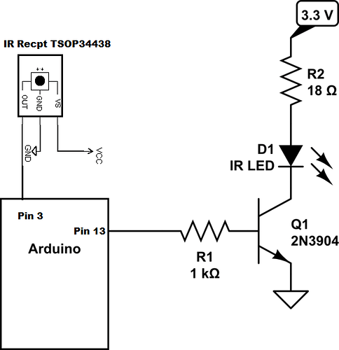

Hello,
I'm working on windows, Arduino V1.8.9 with two official Arduino Micro to transmit datas over IR back and forth between the two of them. I attached my schematic to the post.

Everything work smoothly, the datas are transmited perfectly.
The problem is when I try to make a code with both reception and emission in it, reception doesn't work anymore, the condition never trigger. here is my code (Only one of the board contain this sketch, the other one just transmit data continuously with the initial "emission" sketch):

What could be wrong ? I'm at a loss here. the code enter my receiving function but the "if" is never executed. I tried to put a " irrecv.resume()" before in case it needed a reset but nop it doesn't work.

You have a delay of 500 mS in function receiving(), but in the loop() you call receiving() during a period of 100mS (which is hardly enough time to receive even a single character). Also, the Serial.print debug message may itself interfere with the timings.
Start by commenting out any code in the loop() which is not for receiving, until it works again
Thanks for your answer,
I corrected the delay thing and commented various part of my code and the line that messes up everything is this one :
irsend.sendNEC(0xa90, 16); // NEC TV power code
When I comment this line, everything work fine, the datas are received. .
It is probably something to reset after a send but I have no idea what. the library is quite complicated.
OK. To save me hunting through all the elements of that huge library, can you tell me how you came to choose pin13 as the output pin for the send part ?
The library apparently uses timers for both the receive and transmit part. I could imagine a clash somewhere.
Pin 13 for the output was hard coded in the library, I didn't choose it, I just went through the library and checked the send pin that was defined for my type of board.
Pins are set in the file boarddefs.h
I think it is line 392 for my ATMEGA 32U4

OK. Just to confirm if there is a clash between the resources used to send and to receive the IR codes, try taking a working "receive" sketch and adding this to the end of setup():
 delay(100);
Then post the code that use.
yes when I add those two lines, my working reception code stops working.
OK. If you add these 3 lines to the end of setup() inyour working receive sketch, what happens?
delay(100);
irrecv.enableIRIn ( ) ;  // initialize ?
it actually works,
the arduino is receiving the infos correctly, no problem.
I changed the code a bit according to what you told me and it worked a little better but it is still weird. It receives and prints the correct value (0xa90) once in a while, the rest of the time, the "if" condition isn't triggered.

OK. Don't do this every time in a loop. Just do it only when changing from sending to receiving:

Remove the delay() statements.
I finally fixed it! here it is:

Thanks a lot for your help 6v6gt!
it was some delay messing up everythin and also my "millis()" loop which was too short to allow proper receiving.
