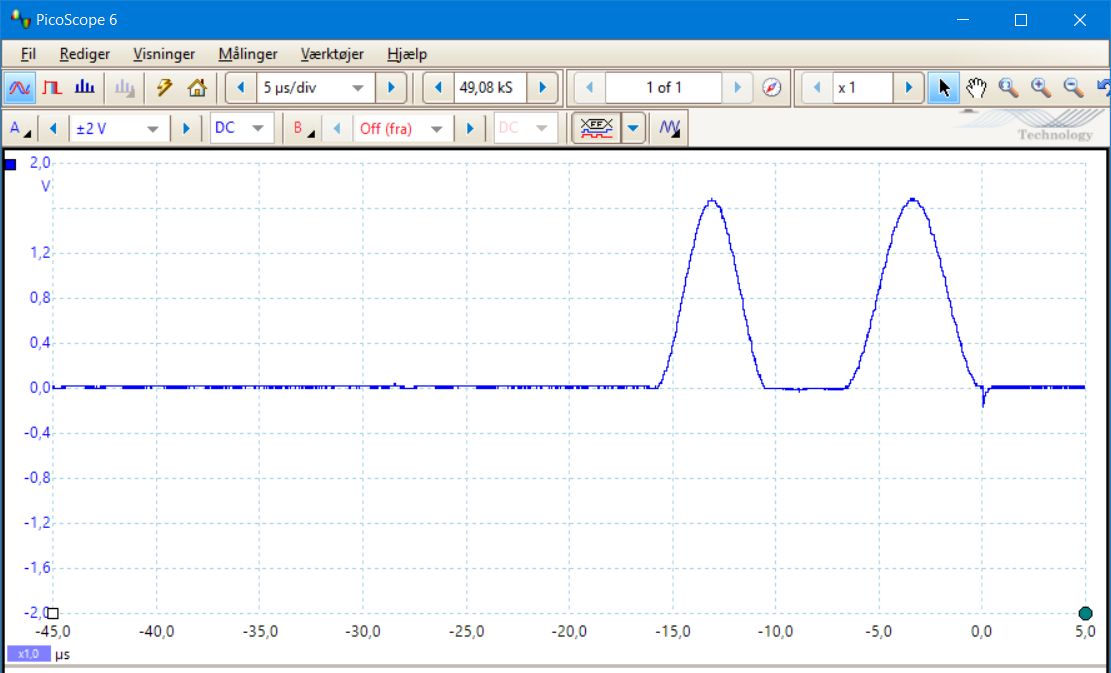

In a loop I write to PortD to make two pulses via a R2R-ladder.

When line 5 is commented out, I get the pulses seen in "WithNOP.jpd", else I get the pulses in "WithoutNOP.jpg".
Why has the pulses in "WithNOP.jpd" different width?
Can anyone tell mee, why the timing is slower without the NOP?
