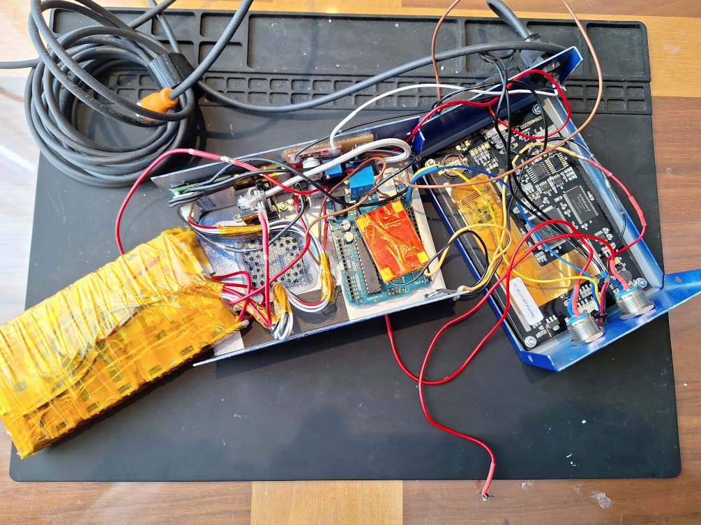

P.S.: There's not more than described:
-Nextion NX8048K050_11
-Arduino Uno
-2x DC-DC converters
-2x hardware buttons
-solenoid switch
-relay assembly
The other parts on the picture are the BMS + some fancy connection assistents...

The solenoid switch is an electromagnetic switch, that needs at least 21V to trigger the shutter. It just gets voltage from me and was bought as a whole thing...I don't know if it has any diodes.

The relay is a complication I'd really just get rid of. It eats power for no really good reason.
The relay is also not the main source of any lag. These sources are (1) the startup behavior of the DC-DC converter and (2) the inherent inertia of the solenoid itself. (1) is easily solved by connecting things in a smarter way. (2) you could overcome or compensate for in other ways, at least to an extent. Here, it depends mostly on how accurate and consistent you need this thing to be.

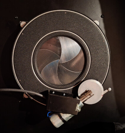

For a photo fellow:
The shutter is for a DIY 30x40cm camera, shooting mostly slow plates in the range of ISO 5. The shutter timings have a generous tolerance of +/- 20% in that case.
I mix all my chemicals from scratch, make my own emulsion and hand-coat my plates. They are then developed as direct positives.
I've spent hours, weeks, months and years to learn all that and get it to the point where I can use it. I'm pretty sure I can learn that coding thing, too :laughing:
I've built a tester derived from the PhotoPlug project. A light sensor is hooked to the microphone input of a PC and then the times are checked with Audacity.

Would it be a solution to use the relay behind the converter, instead of before?
My concern was that the converter uses too much power from my battery in idle, so the relay was hooked before it. At the sacrifice of some accuracy

Yes, putting the switch behind the DC-DC converter will be better.
If you want to make the battery last, consider this:
  • Use a mechanical on/off switch to power down the device when not in use.
  • Forget about the power hungry Nextion display. Use a simple 1620 LCD display with I2C backpack instead.
  • Drop the relay in exchange for a MOSFET.
Coding the project will be fairly easy especially if you ditch the Nextion in favor of a simple I2C display.

Try something like 1k or so.
Better yet, forget about it and use a single MOSFET to switch the shutter solenoid. Google "MOSFET low side switch". IRLZ44 is a popular TO220 logic level MOSFET for projects like yours.
