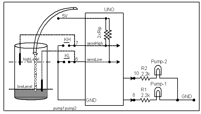

You may get some idea from the following Arduino UNO based two pump system.
pumpQ
Figure-1:
Figure-2:
Algorithm:
(1) When fluid level is at Bottom (equivalent to closing button KL switch), Pump-1 will start.
(2) When fluid level is at Top (equivalent to closing button KH) Pump-1 stops.
(3) When fluid level is at Top and Pump-1 has run for 30-min, Pump-1 stops.
(4) When fluid level is not at Top but Pump-1 has run for 30-min, Pump-1 stops and Pump-2 starts.
(5) When fluid level is at Top (equivalent to closing button KH) Pump-2 stops.
(6) When fluid level is at Top and Pump-2 has run for 30-min, Pump-2 stops.
(7) When fluid level is not at Top but Pump-2 has run for 30-min, Pump-2 stops and Pump-1 starts.
(8) Goto Step-2.
Sketch-1: The following sketch prepared using goto statement for easy understanding and quick development of the program. In programming, the use of goto statement is highly discouraged. In Sketch-2, the goto statement is removed. In Sketch-1, the time delay is 8-sec (for test purpose) and it has been created using TC1 of the MCU. The program senses the end of time delay on interrupt basis.
