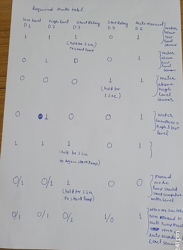

Wondering if you understand the working if you could provide me completely new program satisfying my requirement, debugging is frustrating:(

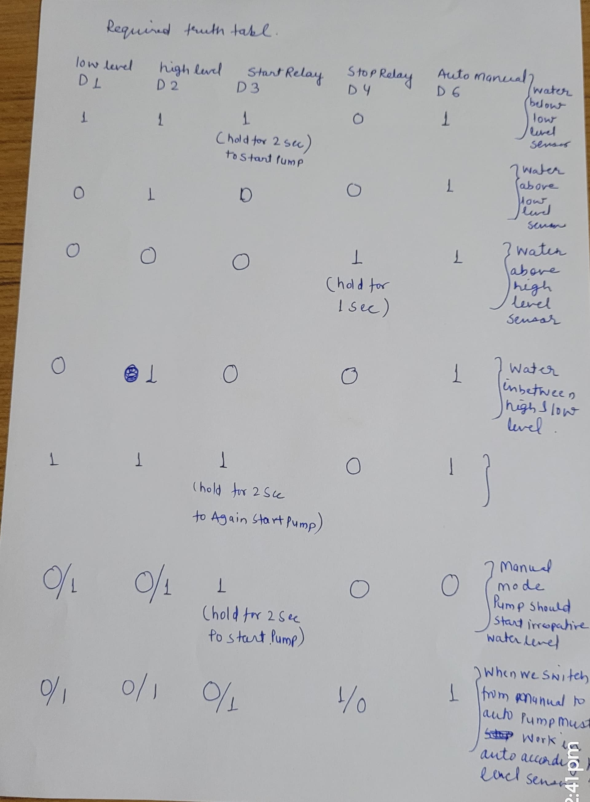

But you need to tell what you expected...
So add a second table that shows what you want. And indicate the differences...
And do the renaming as Tom suggested and post your code again...
Yes debugging is frustrating. But it needs to be done and you will get better at it. And it will prove that it is really worthwhile to spend time on making your program more easy to read (for us but most of all for yourself...).
this is the required truth table
truth table that i want
And now read and study the IPO model to get proper started.
please help in realizing this code.
Especially if you write the entire program before you start testing.
I'd be inclined to disconnect the pump relays and then run the program with a longer delay and examine what the serial output does as you pour water into the reservoir. Then add some additional prints to tell you what the pump is doing.
I'd forget the complication with the start & stop relays too and just simulate the pump with an LED until you get your logic right.
