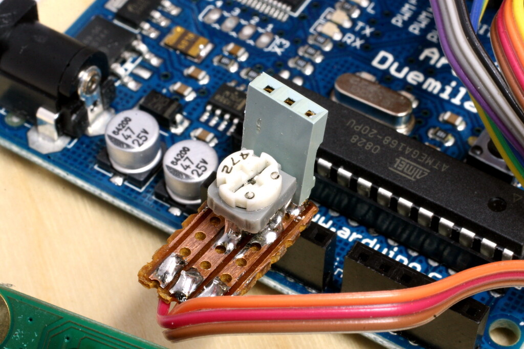

I've just got my first LCD sketch working with a 40 column, two row LCD. The backlight isn't wired up yet, but the text shows up OK. The setup as a whole:
Imgur
Closeup of the power connection, showing the 4.7k Ohm preset potentiometer. I also added a three-socket Berg connector to duplicate the 5V and Ground pins when the LCD is plugged in:
Imgur
