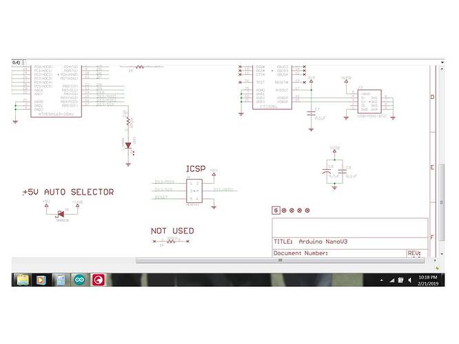

A real Nano has a diode between 5V and the USB supplied power. So one should be able to connect 5V to the 5V pin, and the USB connector to a PC for serial comm's and not have an issue.
A clone, you'd need to investigate yourself.
