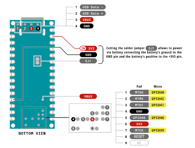

What about this part of the spec:
It's "advanced and not officially supported" part of the spec, but still, it's from arduino's site
