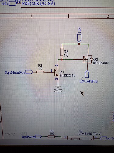

So far i come with this design, could you tell me if its good or maybe i should change anything? Maybe the resistance should be different?
RpiMainPwr is the arduino output pin and 12vToPiPsu is where the Rpi buck converter would be connected and should have 12v if RpiMainPwr is High

You need to flip the P channel MOSFET.
Follow the schematic F1 offered to you in post #3 !

What about the resistance? Should i use the same as in F1 or i have to calculate it somehow?
By the way, IRF9540N is a bit big for my application, is there any sot-23 you could suggest?

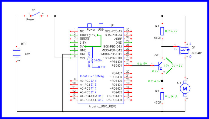

Since you are using an Arduino to turn on a P channel MOSFET, the value of the BJT resistors are not too critical.
The important thing is to measure the Source to Drain voltage when the MOSFET is turned on.
This voltage should be very low, probably less than 0.1Volts.

In examples like this, we want the driver transistor to be fully turned ON when switching power to the load.
Fully turned ON means the transistor should have almost zero volts across the device.
For a BJT we want the transistor to have a very small Vce voltage (voltage collector to the emitter).
For a MOSFET we want the transistor to have a very small Vds voltage (voltage drain to source).
The smaller the voltage across the transistor, the less power it consumes, the less heat it gives off.
Lets say you have a Vds of 6 volts in this 12v power supply project; lets say also that the current flowing in the transistor is 1 amp.
The power consumed by the MOSFET would be P = V * A = 6V * 1A = 6 watts OUCH!
If this same MOSFET only had 0.1 or 0.01 volts the power dissipated would be 0.1 and 0.01 watts respectively.
With the AO3401 the maximum Gate-Source Voltage is +-12V.
Since your 12v supply is at the top of the maximum range for this MOSFET, the circuit below would be recommended.
Note: you can play with the resistor values to reduce power consumption if it is an issue.
ALWAYs measure the Vds of the AO3401 to make sure it is saturated/fully turned ON.
If this voltage is too high, you may have to adjust component values.

By the way, you are mantioning that my 12v supply is at the top of the maximum range for this MOSFET, how ever it wont be power from a battery but from the car witch can have 11.6-13.4v
Does that mean i am better to go with AO4409?
What a question! You should never exceed the rated specifications of any electronic device. If they were not important, no manufacturer would bother to measure or publish them.
