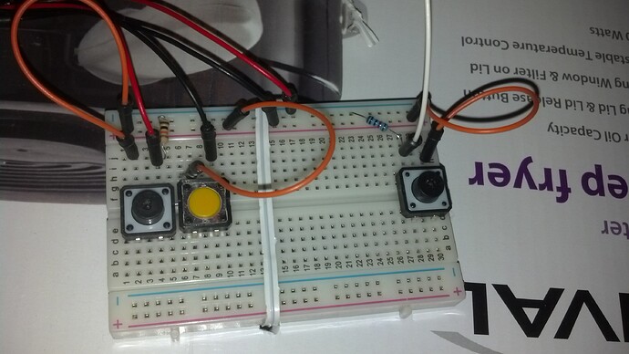

I am working on a timer project with 3 input buttons.
I have a working prototype for the input buttons on a breadboard and I'm trying to get it onto perf board to free up my breadboard for future projects.
on my bread board i have my positive bus connected to 3.3v ground bus to ground,
from the positive bus i have separate 10Kohm resisters going to each button.
I then have a jumper going from each button(same side as 3.3v are connected to resister in a Pull Up configuration).
I then have the other sides of each switch connected to ground so when the buttons are not pushed they read HIGH and when they are pressed it reads LOW.
when I built my perf board version i built it very similar but i made it with 2 differences.
1)I used a single 10kohm resistor (i did this thinking i could save space on the board)
2)I connected the closed side of each switch to each other in series and then ran a single wire to the ground pin on my header.
Im guessing that not having a separate resister on each button is the cause of my trouble, im not really knowledgeable about electronic components, but i imagine that without the resistor on each switch that each of the buttons will read LOW when one button is pressed
I guess im just looking for confirmation that Im on the right track before I proceed.
I also will attach photos of my breadboard and perfboard.
You don't need external pullup resistors at all.

Your description is not PullDown; you have external pullup resistors, and buttons that can connect a pin to Gnd when pressed.

Put a meter on the pin you are pressing the button for, confirm its actually being pulled low.
OK. I think I know whats happening.
on the breadboard with separate resistors on each button, when i press button 1 its voltage drops to 0, but at the same time buttons 2 and 3 drop to about 1.5 volts. the same happens with each button so when it is pressed the voltage drops, but not to 0.
on the perfboard, when I press button 1, or 2, or 3, the voltage on all 3 drops to 0. so it is like i am pressing all 3 buttons at once.
i assume that separating out each button with its own resistor is whats preventing the complete voltage drop on unpressed buttons on the breadboard version.
Yes. As I said, you don't need any resistors. 1 button connects to 1 pin, and Gnd.
yeah. i get that for future project. regardless I found it was simple enough to just put a resistor on each button like my breadboard has and worked with. I got it to work so im satisfied.
