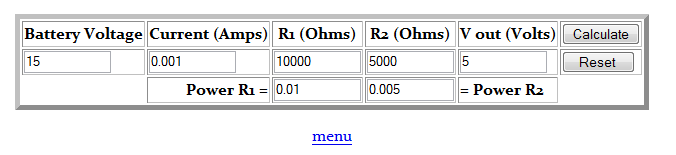

Hmm looks like voltages would be way too high for the arduino... How would I get them to a suitable voltage? Would resisters be appropriate to just get it to a reasonable level for the digital inputs?

use a voltage divider to step the 12V down to 5V. If you Google this forum you will find posts describing this.

Are larger resisters better for this purpose? (Wouldn't they take less draw? I guess its not a huge deal draw is negligible on car battery either way)
I know at least in my car with all electronics off voltage sits around 14.4 peaks as high as 14.6... With car off and audio system on I usually see about 11.5 as low as 10.5ish if i let the battery die down some should be able to take all of those voltages with ease.
If I understand correctly the zener would "short" the input ground/center of resisters to ground with anything over 5.6v in your diagram?

+ 14V  signal-----<<<>>>----------<<< >>>--------- Car Gnd & Arduino GND
                   2.2K      |       1K                |
                                  |        5.6V zener
                             Arduino input pin

So just look up voltage dividers, use a 2.2K on the top, and a 1K on the bottom. The 10K/5K values you have above are fine too... Don't worry too much about the values, as the Atmega chip will recognize a "high" as low as about a volt. Over-voltage is the thing to be careful about.
You're correct about the zener: it clamps voltages in excess of its rating, acting like a short circuit. Since the current through the 2.2K/1K divider is only about 4ma tops, it will be just fine. Best of luck
