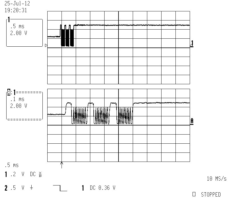

I am new to all this stuff and as my first real Arduino application i would like to use the FM part of a Philips FM1216 tuner module as a standalone FM radio receiver.
But Murphy's laws kind of prevent me from succeeding. I just can't get that damn thing to work...
First question: Why does my sketch only output 3 Bytes of data? (I can see 3 bursts on the SCL-Line with my DSO)
Here's a screenshot. http://gallery.kabelbrand.at/2012-07/i2cduorsch.jpg
Second question: Do I really need external pullup-resistors? I don't wanna read anything from the bus and the Arduino already pulls them to +5V.

Link to the philips data sheet?
Likely stops because slave is not sending back acknowledge bit.

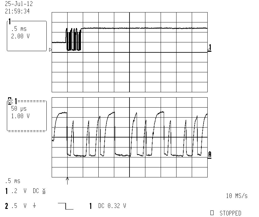

Can you post the SDA line?
This is the Datasheet: http://pvr.sourceforge.net/FM1216.pdf
And this is what the SDA-Line looks like: http://gallery.kabelbrand.at/2012-07/fm1216-sda.jpg
I left pin 6 floating, so the tuner should have the address 0xC2.
Well this is weird...
I just tried the I2C-Scanner sketch from here and it showed me some different adresses. After changing the base address to 0xC3 it now seems that there is some communicating going on. Although i don't hear any audio... But that's a different story :slight_smile:
