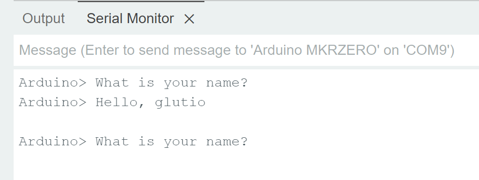

Here is an example of how you can blink in the main loop and run a chatbot as a task.
#include <Arduino.h>
#include "Taskfun.h"
void chatBot(const char* botName)
  while(1) {
    Serial.print(botName);
    Serial.println("> What is your name?");
    while(!Serial.available());
    auto userName = Serial.readString();
    Serial.print("> Hello, ");
    Serial.println(userName);
  while(!Serial);
  pinMode(LED_BUILTIN, OUTPUT);
  noInterrupts();
  setupTasks();
  runTask(chatBot, "Arduino");
  interrupts();
