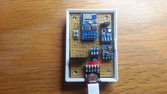

Hi, yes it is possible, depending what you mean by "live".
I have done something similar recently using an esp8266 wifi module, programmed using the Arduino IDE, and an sht21 temp/humidity sensor, which sends its data to a website every 15 minutes.
There are various web services available that will accept and display data from sensors in the form of graphs or other symbols, and many are free. But I decided to take the opportunity to learn more by doing that stuff myself. This gave me the opportunity to learn some PHP, mySQL and SVG graphics, and I am pleased with the results so far.
I have plans to make multiple sensors like this including an outdoor module to measure wind speed and direction as well as temp, humidity, barometric pressure, light levels and so on.

With the techniques i am using, I think updating every second would be difficult. Certainly not every millisecond. But why would you need temperature updates so frequently?
I will post some code for you later. There is an Arduino sketch which reads the sensor, connects to wifi and sends the data using the http GET command with a parameter containing the new sensor reading. A php script on the server responds to to get command, picks up the sensor reading and stores it in a database table using an sql INSERT command. A second php script creates a web page showing the latest sensor readings in a table and and gives links to pages with graphs for each sensor. Another php script creates the graph pages using SVG commands.
The php scripts create html files when needed. When the "client" (your browser or the Arduino sketch) accesses the script, the php code runs on the server and creates an html file which may also contain some svg commands to draw the graphs. This html file is sent back to thr client to be displayed.

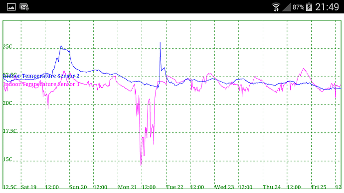

The graphs are drawn with SVG (Scalable Vector Graphics).
Here is the Arduino sketch:
 *  WiFi Indoor Sensor
 *  By PaulRB Nov 2015
 *  ESP-01 Sketch
#include "SparkFunHTU21D.h"
#include <SFE_BMP180.h>
#include <ESP8266WiFi.h>
const float e = 2.71828;
const char ssid[]     = "xyz";
const char password[] = "xyz";
const char host[] = "www.xyz.co.uk";
//Create an instance of the sensor objects
HTU21D humiditySensor;
SFE_BMP180 pressureSensor;
// Use WiFiClient class to create TCP connections
WiFiClient client;
  Wire.begin(2, 0);
  humiditySensor.begin();
  pressureSensor.begin();
  Serial.println();
  Serial.print("Connecting to ");
  Serial.print(ssid);
  WiFi.begin(ssid, password);
    Serial.print(".");
  Serial.println("OK");
  Serial.print("WiFi connected, IP address: ");
  unsigned long startTime = millis();
  float humidityNow = humiditySensor.readHumidity();
  float temperatureNow = humiditySensor.readTemperature();
  float absoluteHumidityNow = (6.112 * pow(e,(17.67 * temperatureNow)/(temperatureNow + 243.5)) * humidityNow * 2.1674) / (273.15 + temperatureNow);
  double temperature2Now;
  delay(pressureSensor.startTemperature());
  pressureSensor.getTemperature(temperature2Now);
  double pressureNow;
  delay(pressureSensor.startPressure(1));
  pressureSensor.getPressure(pressureNow, temperature2Now);
  Serial.print("New sensor readings: Temperature:");
  Serial.print(temperatureNow, 1);
  Serial.print("C");
  Serial.print(" Humidity:");
  Serial.print(humidityNow, 1);
  Serial.print("% = ");
  Serial.print(absoluteHumidityNow, 1);
  Serial.print("g/m3");
  Serial.print(" Pressure:");
  Serial.print(pressureNow, 1);
  Serial.print("Pa");
  Serial.print(" Temp2:");
  Serial.print(temperature2Now, 1);
  Serial.print("C");
  Serial.println();
  Serial.println();
  Serial.print("connecting to ");
  Serial.println(host);
  const int httpPort = 80;
  if (!client.connect(host, httpPort)) {
    Serial.println("connection failed");
    return;
  if (!sendSensorUpdate("T2", temperatureNow, false)) {
    return;
  if (!sendSensorUpdate("H2", humidityNow, false)) {
    return;
  if (!sendSensorUpdate("A2", absoluteHumidityNow, false)) {
    return;
  if (!sendSensorUpdate("P1", pressureNow, true)) {
    return;
  Serial.println();
  Serial.println("closing connection");
  Serial.print("Total time: ");
  Serial.println( millis() - startTime);
  Serial.println("Sleeping...!");
  delay(900000UL); // 15 mins
  Serial.println("Awake!");
boolean sendSensorUpdate(char* sensorName, double sensorValue, boolean closeConnection) {
  // We now create a URI for the request
  String url = "/script.php";
  url += "?sensor=";
  url += sensorName;
  url += "&value=";
  url += sensorValue;
  Serial.print("Requesting URL: ");
  Serial.println(url);
  // This will send the request to the server
  if (closeConnection) {
    client.print(String("GET ") + url + " HTTP/1.1\r\n" +
                 "Host: " + host + "\r\n" +
                 "Connection: close\r\n\r\n");
  else {
                   "Host: " + host + "\r\n\r\n" );
  while(!client.available()) {
    if (millis() - startTime > 30000UL) {
      Serial.println("request failed");
      return false;
    delay(100);
  // Read all the lines of the reply from server and print them to Serial
  while(client.available()){
    String line = client.readStringUntil('\r');
    Serial.print(line);
  return true;

And finally here is the php script that creates the graphs:
<!DOCTYPE html>
<html>
<body>
<?php
// Sensor Graph Script
// PaulRB
// Nov 2015
$sensor = $_GET["sensor"];
$view = $_GET["view"];
$servername = "www.xyz.co.uk";
$username = "xyz";
$password = "xyz";
$dbname = "xyz";
$colours = array("magenta", "blue", "red", "yellow", "cyan", "black");
// Connect to database
$conn = new mysqli($servername, $username, $password, $dbname);
if ($conn->connect_error) {
    echo "Sorry, the website is experiencing problems: " . $conn->connect_error();
    exit;
// Get sensor description and min & max values to be plotted
$sql = "SELECT   i.sensor_units,
                 MIN(s.sensor_time) AS min_time, MAX(s.sensor_time) AS max_time,
                 MIN(s.sensor_value) AS min_value, MAX(s.sensor_value) AS max_value
        FROM     xyz_sensors s
        JOIN     sensor_info i ON i.sensor_name = s.sensor_name
        WHERE    s.sensor_name like '$sensor%'
        AND      s.sensor_time > NOW() - INTERVAL $view DAY
        GROUP BY i.sensor_units;";
if (!$result = $conn->query($sql)) {
    echo "Sorry, the website is experiencing problems.\n";
    exit;
$reading = $result->fetch_assoc();
$min_value = $reading['min_value'];
$max_value = $reading['max_value'];
$min_time = strtotime($reading['min_time']);
$max_time = strtotime($reading['max_time']);
$units = $reading['sensor_units'];
echo "<h1>Sensor Graphs ";
echo "<a href='http://$servername/graph.php?sensor=$sensor&view=1'>24 hrs</a> ";
echo "<a href='http://$servername/graph.php?sensor=$sensor&view=7'>7 days</a> ";
$sensor_type = substr($sensor,0,1);
echo "<a href='http://$servername/graph.php?sensor=$sensor_type&view=$view'>compare</a> ";
echo "<a href='http://$servername/sensors.php'>index</a> ";
echo "</h1>";
// Choose scale for vertial axis (sensor reading)
if ($max_value - $min_value > 100) $value_scale = 10;
elseif ($max_value - $min_value > 30) $value_scale = 5;
elseif ($max_value - $min_value > 10) $value_scale = 2.5;
elseif ($max_value - $min_value > 5) $value_scale = 1;
elseif ($max_value - $min_value > 3) $value_scale = 0.5;
elseif ($max_value - $min_value > 1) $value_scale = 0.25;
elseif ($max_value - $min_value > 0.5) $value_scale = 0.1;
else $value_scale = 0.05;
$min_value = $value_scale * floor($min_value / $value_scale);
$max_value = $value_scale * ceil($max_value / $value_scale);
// Choose scale for horizontal axis (time)
if ($view < 7) $time_scale = 2 * 60 * 60;
else $time_scale = 12 * 60 * 60;
echo "<svg width=100% viewBox='0 0 1000 500' >\n";
// Draw graph
echo "<rect x=0 y=0 width=1000 height=500 stroke=green fill=none stroke-width=2 />\n";
// draw vertical axis (sensor values)
for ($y = $min_value; $y < $max_value; $y +=$value_scale) {
    $yv = round(500 - 500 * ($y - $min_value) / ($max_value - $min_value), 0);
    echo "<line stroke=green stroke-dasharray='5,5' x1=0 y1=$yv x2=1000 y2=$yv />\n";
    echo "<text fill=green x=0 y=$yv >$y$units</text>\n";
// Draw horizonal axis (time)
for ($x = ceil($min_time / $time_scale) * $time_scale; $x < $max_time; $x += $time_scale) {
    $xv = round(1000 * ($x - $min_time) / ($max_time - $min_time), 0);
    echo "<line stroke=green stroke-dasharray='5,5' x1=$xv y1=0 x2=$xv y2=500 />\n";
    echo "<text fill=green x=$xv y=500 >";

No, i did not use an ethernet shield. I used an esp8266 module. These modules have wifi built in and their processors can be programmed using the Arduino IDE.
Here is a picture of the sensor i built recently. The module at top centre is the esp8266.
Hope that help a little.
The below might be a display option.
