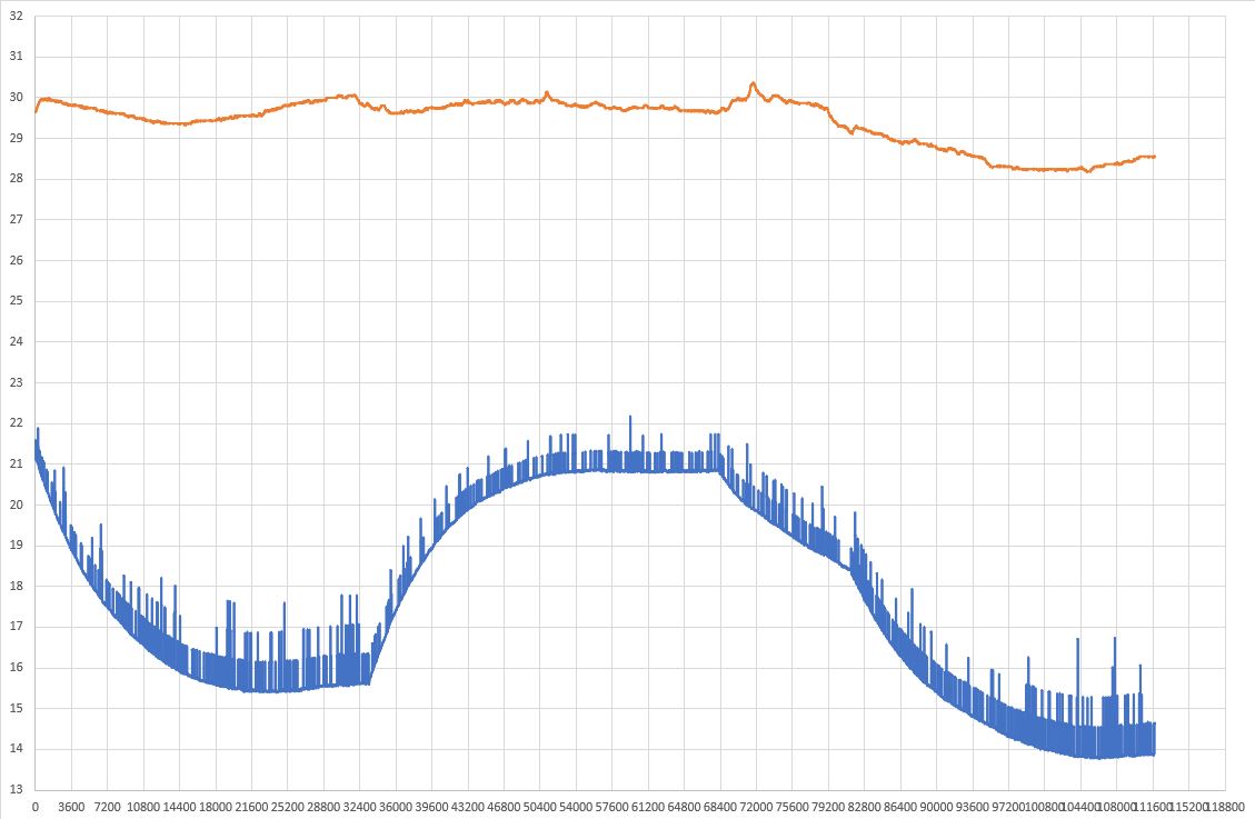

I'm have an insulated box in which there are about 4-5 liters of water which are cooled/heated by a Peltiers, driven by DC-DC buck convertor as variable CC source. The reversing of heating-cooling is done by reversing the polarity with relay. The setpoint vary gradually between 16 and 25 degrees C on hourly schedule with speed between 0 and 2 degrees per hour. The box is placed in a room, which temperature can vary between 18 and 30 degrees with small hourly changes and big seasonal changes.

Here is a step response of the open loop system:
The sensor that measure the inside temp is located very close to the water outflow from the Peltiers heatsink. The value jumps for some unknown reason that I have to investigate. The red line is the ambient temperature. First step is done on a stable system by switching on the lights over the box (it is illuminated and the lamps heat it for some extent) plus lowering the peltier current from 2.248A to 1.284A. Second step is increasing the current from 1.284A to 1.776A with lights still turned on. For the third step I didn't have time to wait for stabilization, it consists of further increasing the current from 1.776 to 2.259A and turning off the lights. The horizontal axis lines are on every hour. From this picture it cannot be seen, but the deadtime is small, it is hard to measured it, because in the moment I'm regulating the current by turning a potentiometer, so it takes some time and the step is not really rectangular, but I can say it is under 30 seconds. The measurements are taken every second, this is the minimum period that the sensor allows.
I suspect, that the step response will be very different if done on lower ambient temperature or even more if done in heating direction.

Cooling power of the Peltier is proportional to the current. This part is linear, but the change of the current changes the hot side temperature, which changes the heat transfer rate. This is why the chart look like this:
Heating is even more complex, because the the generated heat on the hot side is sum of the transferred heat + current generated heat, which is propotional to the square of the current.
