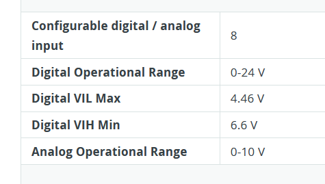

@jremington why you write 0-24 input? according to technical specification the opta input is 0-10V and the power supply may be 5V with a dedicated power supply. I read many times that DS18B20 is not suitable, but not clear to me WHY.

You are quoting the analog operational range. The digital operational range is 0-24V. Clearly, you need to become more familiar with the operating characteristics of the Opta, and industrial equipment in general.

So. If we raise the GND from 0 Volt to 2.5 Volt (ie. by a 2.5 Volt Zener Diode) and lower the 10 Volt to 7.5 Volt (ie. by a 2.5 Volt Zener diode), then the DS18B20 would be in the right interval, is that not true???
This is based on that you noted VIL max 4.46 Volt, and VIH min to be 6.6 Volt, because, with a lift of 2.5 Volt from GND, I guess VIL would then become 1.96 Volt, and VIH would become 4.1 Volt - meaning, that the DS18B20 just COULD (maybe) be able to operate??? Question is then, if these "inputs" can be configured also as outputs???
