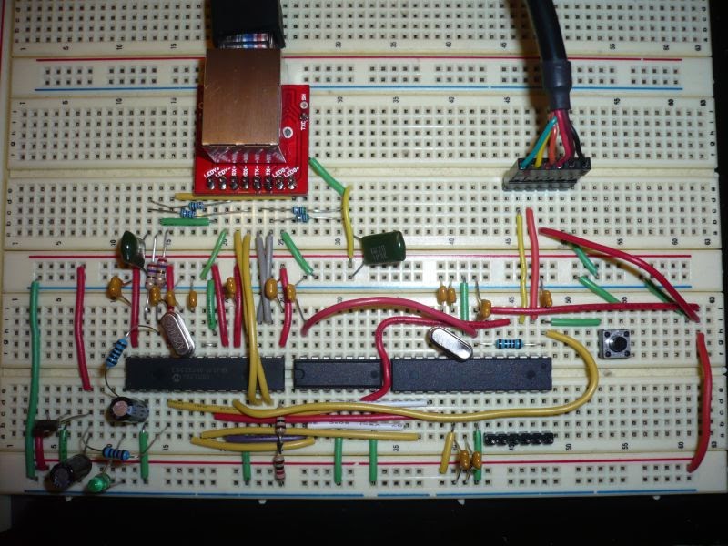

Hi Ill_switch,
I just built up the same ENC28J60 / ATmega328 combination on breadboard yesterday and initially tested it with the NuElectronics code. Here's some tips - where I went wrong.
  1. Make sure that the 5 Vdd and 4 Vss pins on the ENC28J60 are all connected.
  2. Make sure that your 3V3 regulator can supply enought current - the first regulator I used suffered extreme voltage droop when I connected 3V3 to the mid point of the 50R Tx network termination resistors.
  3. Make sure that you have lots of 100nF decoupling on the ENC28J60 and a good 10uF minimum reservoir cap on the 3V3 rail.
  4. Recheck all your SPI bus wiring. There's only 4 wires but make sure that /CS is correct, MISO and MOSI. If you are using a 74XX08 as the level shifter make sure that it is powered from 5V.
When you reset the '328 the ENC28J60 should be reset too - join the reset pins together.
The yellow and green leds will flash twice if the '328 is correctly talking to the ENC28J60.
The NuElectronics server worked fine as soon as I sorted out my lack of 3V3 current. I then loaded Andy Lindsay's Pachube Client code that I had running on the Nuelectronics shield - and that works fine too.
There's not much to go wrong, but invariably it will be a wiring fault or a missing connection.
I've done a write up here.
Good luck in getting it to work - you really won't be far off having it run.
G.
