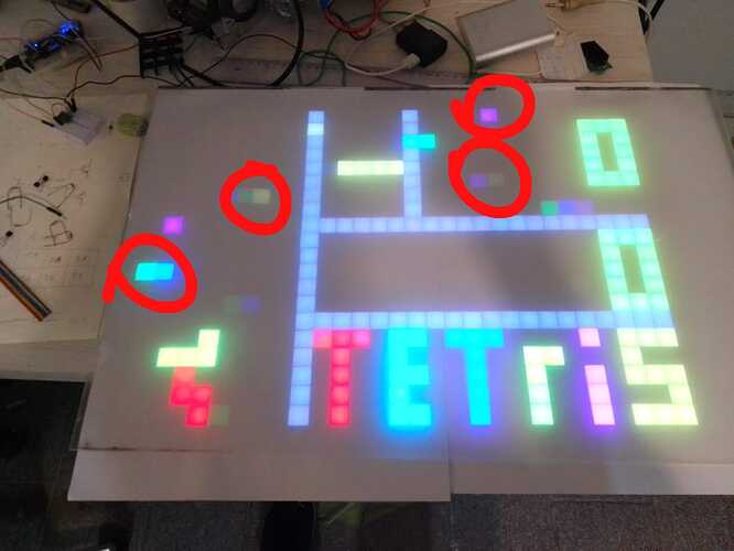

Hi!
now i have a problem with any leds that are blinking spontaneously, the image is print correct, but are this leds on that i don´t programed to turn on,
i use a suply power 5V 30A,
what can cause that problem?
see a example on the image attached.
hi!!
it was any problem with adafruit neo pixel library.
I migrate it to fast LED library and resolve the problem.
