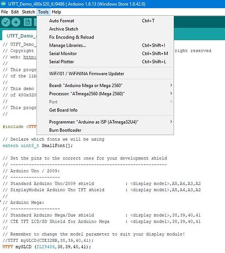

  1. Then, I connected Arduino Mega 2560 that I borrowed with the TFT display. Having a different issue with Mega 2560, kind of starting trouble :-). In Arduino IDE, I selected "Arduino Mega" board. but the Port menu is not getting enabled, even (see the attached screenshot).
This is preventing me from running the program on Arduino Mega. Upload gives the error saying port is not selected. But I cannot select the port since the Port menu is disabled.
I looked further in Windows Device Manager, looks like the Mega 2560 is not getting detected properly by Windows (please see the attached screenshot showing Windows Device Manager). I suspect some kind of Windows driver issue. Not sure, how to resolve this issue.

Just unplug and re-plug in the USB cable to the MEGA2560.
Try another USB cable.
Try another USB socket on the PC.
If you don't see a COM Port then the MEGA2560 is damaged. Whinge to the friend that you borrowed it from.
