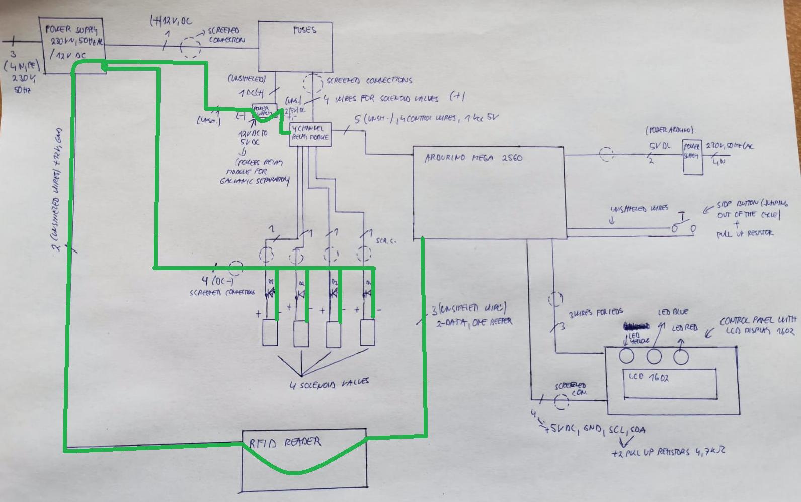

I use in my circuit: 12 V DC power source - from it in shielded wire it goes to a 4 channel relay. I have 4 solenoid valves all are used everything is connected in shielded wire.. a diode is parallel to each valve. then it goes backt to 12 DC power source... The relay is powered from a separate 5 V source is galvanically separated from Arduino... Only the control wires are connected between the Arduino and the relay and one 5 V wire ... The arduino is powered by a classic USB charger... Then I have an LCD display in shielded wires it is powered by the Arduino and I have pull up resistor on data wires (1602)... Then I have a classic button... to stop the cycle.. in unshielded wires and with pull up resistor....then I have and RFID reader and I think that may be a problem... The rfid is in unshielded wires... is it powered from the same 12 V source as the solenoid valves. then it goes directly to Arduino (I dont use any resistors) - 4 wires... 2 data, 1 beeper, one LED.

Also please make a simple pencil drawing showing all the connections and post a photo of the drawing. It is much too easy to misunderstand a textual description of connections. See this Simple Image Posting Guide

I can't see the flyback diode connected across the coil of the solenoid valve on your transparent diagram.

I apologize for the delay, attached is a simple wiring diagram and code.. I will also give a photo of the LCD display here... Thank you :slight_smile:

Although you have a separate supply for the relay module, I'm sure you wouldn't have opto isolation because there would be a ground connection from the 230VAC-12Vdc supply to the RFID reader and then to the Arduino Mega. The 12VDC-5VDC supply uses the same ground which is connected to the relay module.

Thank you for your advice. I forgot one wire. The GND wire between RFID and Arduino. I have already connected that, because the reader doesn't work without it. My connection between the relay and the Arduino is this, link below:
Is that right? I removed the jumper and connected exactly like this. The solenoid valves are about a meter away. Those solenoid valves are located in another cabinet (unfortunately it's a wooden cabinet). The relay and Arduino are in a different wooden cabinet...; are drilled into the wall on a plastic plate... The Arduino on the valve side has a metal box, that is grounded (PE wire 12 DC power supply - actually the input to the power supply AC 230 V, 50 HZ, L - N - PE. The box is connected to PE.

I've highlighted what I think the ground path is on your circuit. Your 12V-5Vdc supply for the relay module probably doesn't have isolated grounds. Now, the same ground that reaches the relay module is sneaking around through the RFID reader to the Arduino as shown. Also, the same ground for the solenoid valves reaches the Arduino.
If you have an ohmmeter, try checking the resistance or continuity from relay GND to Arduino GND and see what it reads.
As another test, I suspect that if you disconnect the RFID reader and its GND connection to the Arduino, the problem will go away.

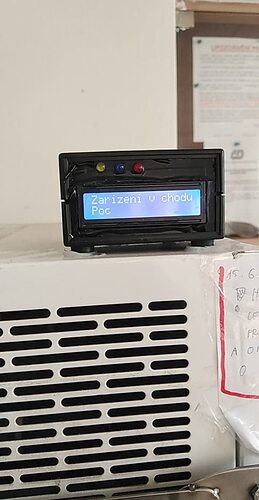

My colleagues have reported these errors to me:
  1. The program freezes again - see the first photo (the yellow LED has stopped flashing - it is in a cycle of seconds) and the display froze too.
  2. They said that the whole display turned off (see second photo) and I don't know why... They told me that when they pulled out and turned on the power (230 V, 50 Hz) that again everything started working as it should, display too.
    EDIT: but in the second photo you can see that only brightness went out.
So it makes me a little tired :smiley: because I tried a lot... Thank you for all the advice.
First photo:
Second photo:
