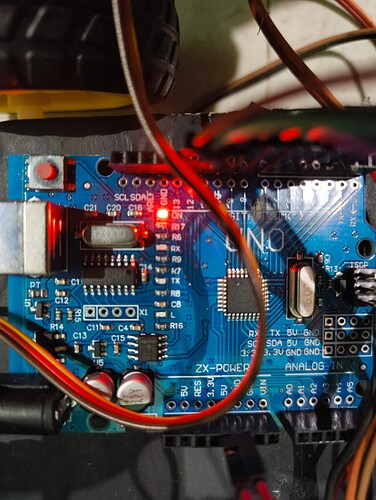

So I am creating a project for school on obstacles avoiding car. So I followed a video and created a car exactly as shown in the video and when I uploaded the code the servo motor started moving. But when I removed the cable and turn on the battery only the "on" light is turned one and there is no response.
This is my uno

What battery and where did You "turn on" it?
Please add all of the power sources to your frizzy. Post links to there technical specifications.
It's 3 lithium ion each 3.7 vols and I have connected a switch to turn it on
Where did You connect that okey battery?
Please postactual images of the power source and wiring
