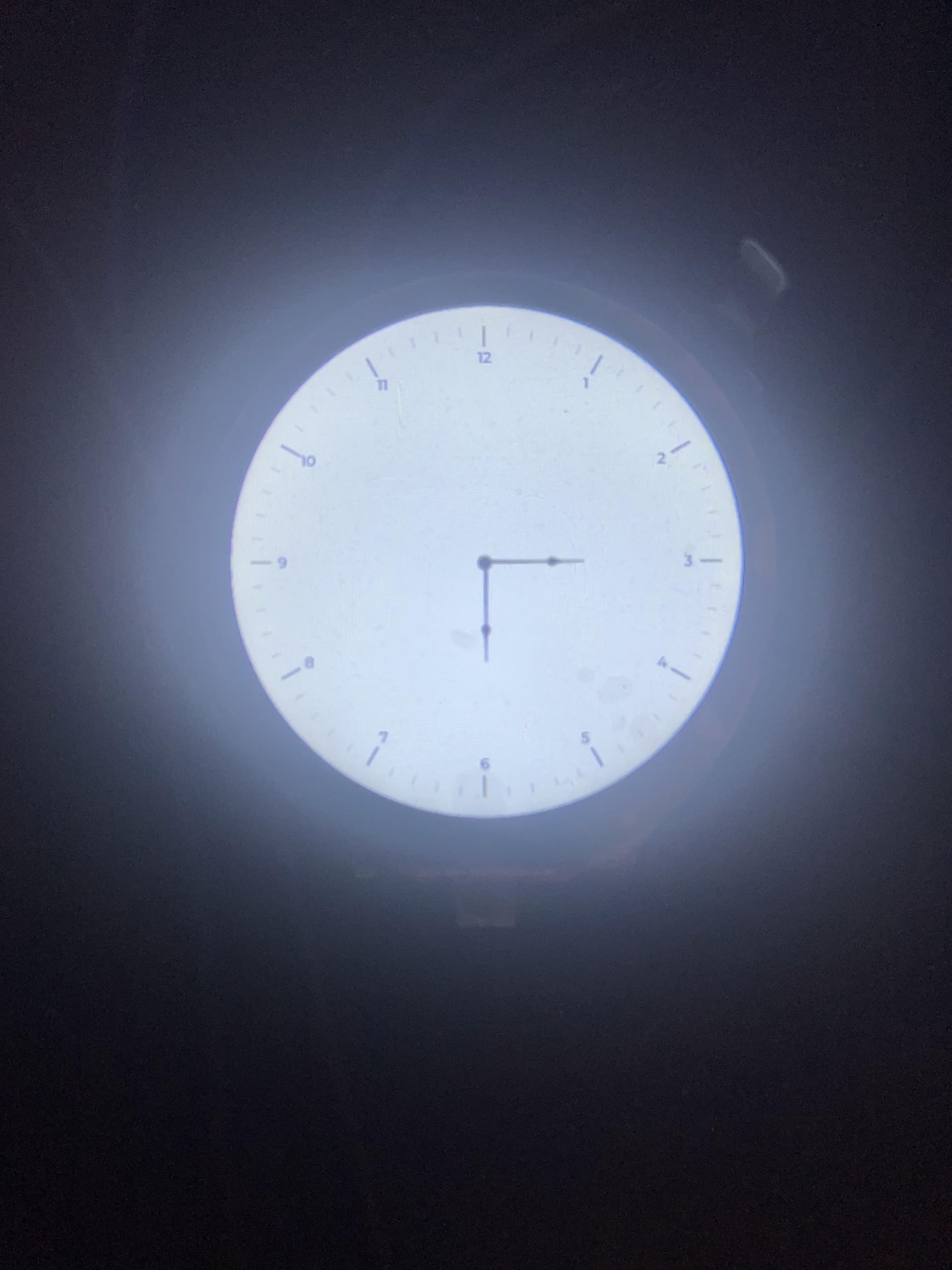

The Example Code Displays the Incorrect Clock Time
The example code is able to compile and display images, but the time displayed is incorrect and I'm not sure why. I am super new to Arduino.

How is the time incorrect? Is it total gibberish, is it out by seconds, hours, minutes, what?
Why do you think that this relates to Avrdude, stk500, Bootloader issues - Arduino Forum?
Topic moved to a more suitable location on the forum.
it displays a clock with the small and big hand pointing incorrectly
Is it just a hour off? Or two hours, 22 minutes and 33.333 seconds? Or is it mirrored/flipped. Or ...
I'm sure you can come up with a better description. I think (but not sure as you're a new user) that you can actually drop images in a reply window.
Incorrectly how? If you can't be precise no one can help you.
I apologize for the vague description. Here is an image of the clock at roughly 12:35 am IRL
@sterretje
Thanks.
I unfortunately have no experience with anything that you are using so can't help further. I hope somebody else has an idea.
Did you changed default WiFi SSID and pass in the code to your actual ones? Did the board connected to the internet?
Yeah, the board is connected to the internet.
How did you adjust the code to take into account the offset between UTC and your local time?
Looks like it's supposed to happen in the datetimeSyncTask function by pulling the local time zone from https://ipapi.co/timezone/. Don't know if it actually works.
Ahhh .... now I see that it doesn't work. If I go to that web page (I'm on USA East Cost), it replies: America/New_York and @jmethis's code tries to set the TZ environment variable to this value. But, that's not how it needs to be done! TZ needs to be set to a POSIX time zone string: https://support.cyberdata.net/portal/en/kb/articles/010d63c0cfce3676151e1f2d5442e311
@jremington When I go to the same webpage it displays America/Los_Angeles
This is what I've tried changing :
  • I manually changed the root certificate header file to the one provided by this link https://ipapi.co/timezone/
  • By doing this, the board now displays that is closer to America/Los_Angeles time (Its ahead by one hour)
  • I changed DEFAULT_TIMEZONE to the US/Los Angeles time string that is defined in the zones.h header file. This did not change anything.
  • I tried adjusting the day light offset and gmt offset; this was not able to change the time displayed.
  • I tried changing the NTP servers as well with no luck
    It appears that the board is displaying mountain daylight time for some reason

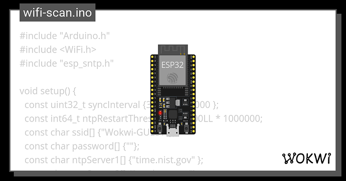

Thanks for posting this. I'm here because of the same problem.
I further boiled down your example:
#include "Arduino.h"
#include <WiFi.h>
#include "esp_sntp.h"
  const uint32_t syncInterval {3600UL * 1000 };
  const int64_t ntpRestartThreshold = 3600LL * 1000000;
  const char ssid[] {"Wokwi-GUEST"};
  const char password[] {""};
  const char ntpServer1[] {"time.nist.gov" };
  const char ntpServer2[] {"pool.ntp.org"};
  uint8_t attemptsBeforeReset { 5 };
  uint8_t retryTest { 0 };
  bool resyncNtp {false};
  tm *timeinfo;
  timeval tv;
  time_t now;
  vTaskDelay(1000);
  Serial.print("Connecting to WiFi ");
  WiFi.begin(ssid, password);
    Serial.print(".");
  Serial.println(" Connected!");
  sntp_set_sync_interval(syncInterval);
  configTzTime("EST5EDT,M3.2.0,M11.1.0", ntpServer1, ntpServer2);
  Serial.println("Waiting for time synchronization...");
  while (time(nullptr) < 100000) {
    Serial.print(".");
  Serial.println(" Time synchronized!");
  time(&now);
  timeinfo = localtime(&now);
  Serial.printf("Current time: %s", asctime(timeinfo));
  // Your loop code here
and it works on this emulator:
but, I can't seem to get it to work on a real esp32 board (when replacing my wifi credentials above).
I don't think it is my network or firewall, as other devices on the network are working fine.
A bit of a mystery.
never mind, its not the code. rather than try to connect to my network, i connected to my cell phone's wifi hotspot and it worked right away. So either something with my network or ISP (most likely the former).
