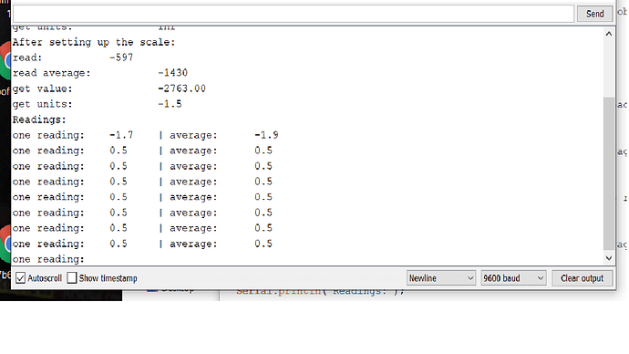

Hi, I am working with the project using the loadcell HX711 but I do not know which step that I did wrong because whenever I upload the file it always turns out the same results even I put some stuff on the loadcell. I really need help.

You must initiate "scale" before You use that function! Look at the fifth code line in Setup()!
That looks like standard example code which should work fine. Check your wiring.
Did you connect the grounds?
