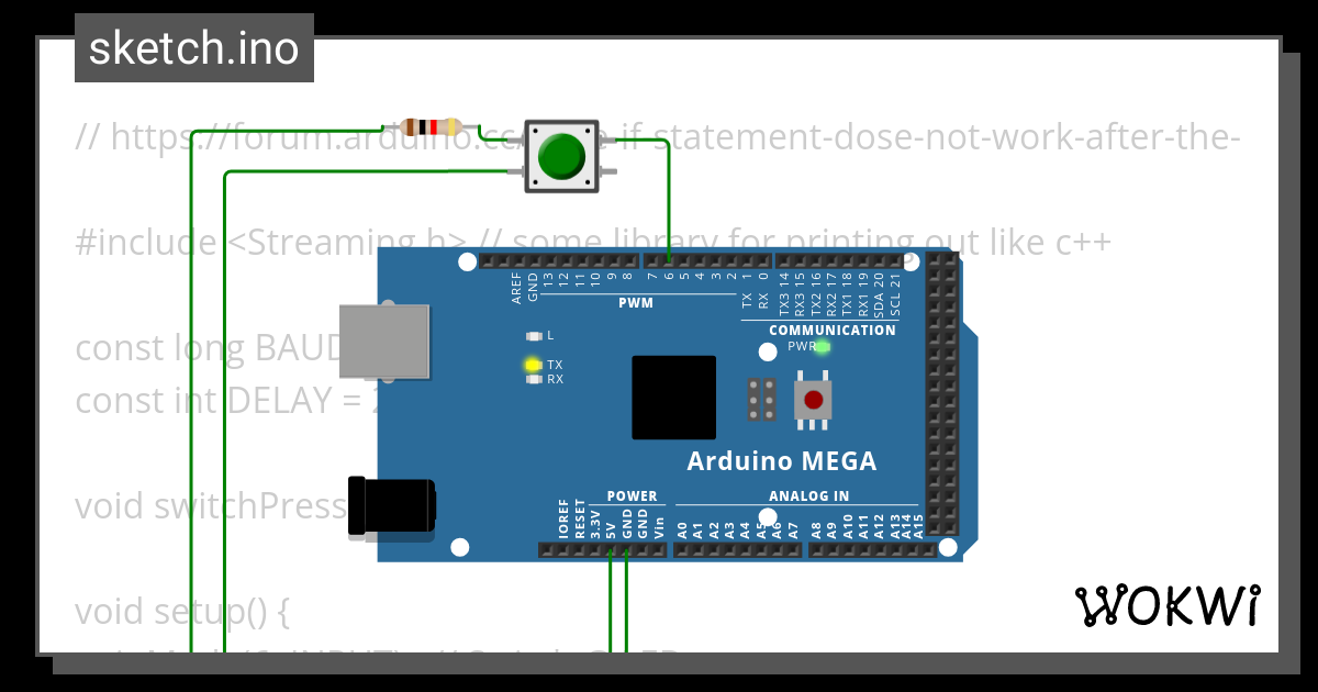

Hello, My problem is simply that
If I put if statement to start the program when the switch which connected to the pin 6 is pressed, so I run the program and it is worked fine at the first time, but when I use the recursion to restart the program when some condition is true , suddenly the program activates the if statement even when the result of the logic expression is ZERO !!! and it is not just activated the IF statement, in my example it pass a print command also !
my code here is not my real program that I want to make but I tried to make it simple for represent the problem I had.
my code:

and this is my OUTPUT:
as you can see the program is stuck because I did not press the switch yet
when I pressed it the program activated the if statement and printed that "the program pass ... " !!
then I pressed it again and the program print that it will restart and will enter the recursion
when it restarted the program printed that the logic expression is zero one time and stopped !! unlike the first time so the program activate the if statement when the logic expression is zero after the recursion.
You should not call loop() from your switchPress function because you will run out of memory that way. Instead, just return.
Why on Earth are you calling loop() from inside the loop() function ? That does not restart the sketch, only the loop() function

You do not see the "program pass" message because the pin is low when loop() is called. You do see the other message because of the infinite while loop inside of your main loop() function.
Again, I would not use recursion unless you have a good reason to do so.

Yes it will because within the infinite loop, switchPress is called, which calls loop whenever the pin is low.
your switchPress() function is CALLING loop(). When loop() reaches its end, WHERE do you suppose it is going to return to? Hint: it will NOT return it main, as it should/needs to.
NEVER explicitly call loop()!! Nothing good will happen if you do.

Do you know what recursion means in the context of programming ?
Recursion is fine, IF you understand the execution path once you start the recursion. Clearly, in this case, you do not. Think about my question. Once you explicitly call loop(), what is loop() going to do. Once loop() reaches the end, WHERE is it going to return to?
It is NOT where you seem to think, and that is the root of your problem.
yes, it recall the function until the point you recalled.
Let's try this a different way...
  1. main() calls loop()
  2. loop calls switchPress()
  3. switchPress() calls loop()
  4. ?
  5. ?
  6. ?
You tell me what steps 4, 5, and 6 in the above sequence are.
Have fun.
