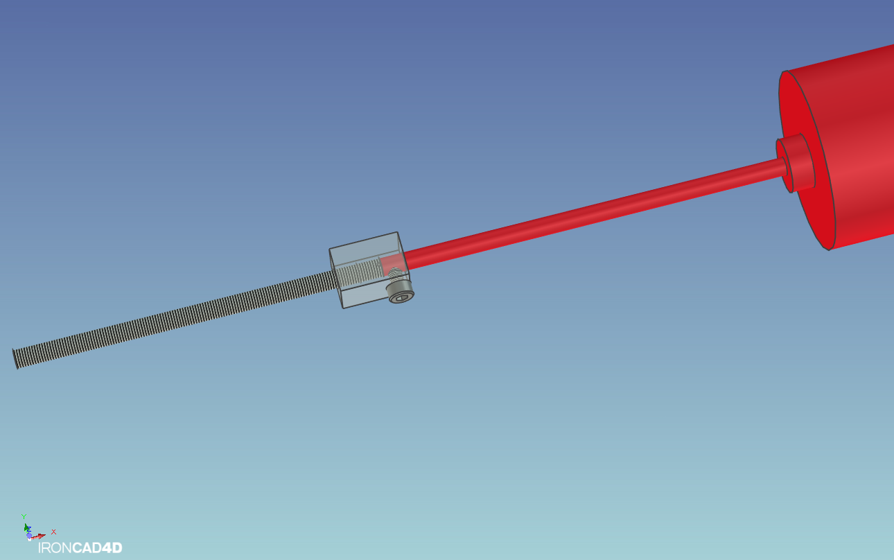

after looking again at your pictures.
The planetary gear outputshaft is out of steel. You extended it - I guess with hotglue and a wooden stick. Well if the front end is made out of steel the higher thermal conductivity might melt the hotglue connection.
At the place where you live is there some kind of steel good shop? Or a DIY-shop?
A threaded rod out of stainless steel would be a good option.

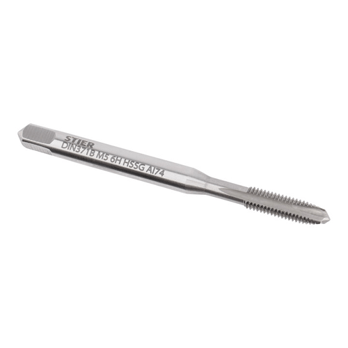

Do you have a drilling machine and a set of thread drills?
A small block out of aluminium with two threads M3 / M4 as the connection between shaft and threaded rod
