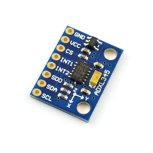

The sampling speed is too low
Hello, I'm using Arduino Mega 2560 with I2C sensor ADXL345. And I'm using delay(1) to control the sampling interval at 1 millisecond, neamly I should have 1000 sampling points per second. However, the output is far less than 1000, it is only around 80 points per second. The output data rate of the sensor is 800 Hz and the excitation frequency is 1000 Hz. I also tried millis() to control the sampling rate, no developing.

Start by increasing the baud rate of the Serial printing. 9600 baud is really pathetic
modern standard baudrate is 115200.
I have tested arduino Unos and Megas they work up to abudrate of 250000 reliably
Depending on how much samples you want to collect it might be an option to store the samples in an array and after dampling do the printing.
best regards Stefan
9600 baud will only let you print 960 characters/second, and the loop time is going to vary depending on the value of the numbers you are printing (larger numbers that take more characters will take longer to print).

To solve the sampling rate problem, you need to tell us which ADXL library you are using, where you downloaded it, and/or how you installed it.
I'm using the ADXL345.h which comes form the example on the website of the Seeed Studio, https://github.com/Seeed-Studio/Accelerometer_ADXL345. I find a same-name one from the IDE library, they might be the same.

Another reason might be the speed of I2C.
At what clock-frequency does the I2C-bus run?
I guess you don't know. You will have to look up the datasheet what the maximum-bus-frequency is
I was googling for ADXL345 andfound this product
It meantions SPI
The SPI-bus is much faster than I2C.
So this might be an option too.
You should post exactly that ADXL345 Sensor or ADXL345-board that you are using.

The datasheet has a table that shows different sampling rates
Which mentions a Rate Code.
So I guess you will have to adjust this Rate Code
best regards Stefan
My code demonstrates two details for you and us.
  • Your loop, with only minimal serial output, still executes at roughly 10ms +/-, per sample. So no amount of serial tuning will help. What I was trying to expose was whether your verbose serial output per per loop was in fact impacting your loop rate; inconclusive, but unlikely.
  • The verbose output, though, will cause grief sooner or later, as your output buffer isn't large, so you'll eventually end up with a full output buffer, at which point the code proceeds only as quickly as the buffer empties. You might not see an effect at 200 Hz, but this is going to get WORSE as you improve the loop speed. Beware.
My comment about libraries, points you to installable libraries in the IDE. You've identified, now, that Seeed is involved, so that's likely the library, though GOK which version you have vs which version is installed by the Library Manager.
Probably not, as there are many with the same or very similar name.
Use an ADXL library that is well documented, and start with the example code from that particular library.
Hello StefanL38, this is my sensor https://wiki.seeedstudio.com/Grove-3-Axis_Digital_Accelerometer-16g/, and it works with * Grove Base Shield V2.0 for Arduino https://www.seeedstudio.com/Base-Shield-V2.html.
I've found the same table about my apparatus. Do you know how to set the power mode and Rate Code in Arduino IDE? And because I use several sensors at the same time. So I'm also using the Multiplexer https://www.seeedstudio.com/Grove-8-Channel-I2C-Hub-TCA9548A-p-4398.html. Under this circumstance, how do I set the different power mode and Rate code?
I used the Rate Code 0b1101 so that the ODR should be 800Hz and changed the power mode to 0x2C, the output sampling rate is still around 200 Hz.
