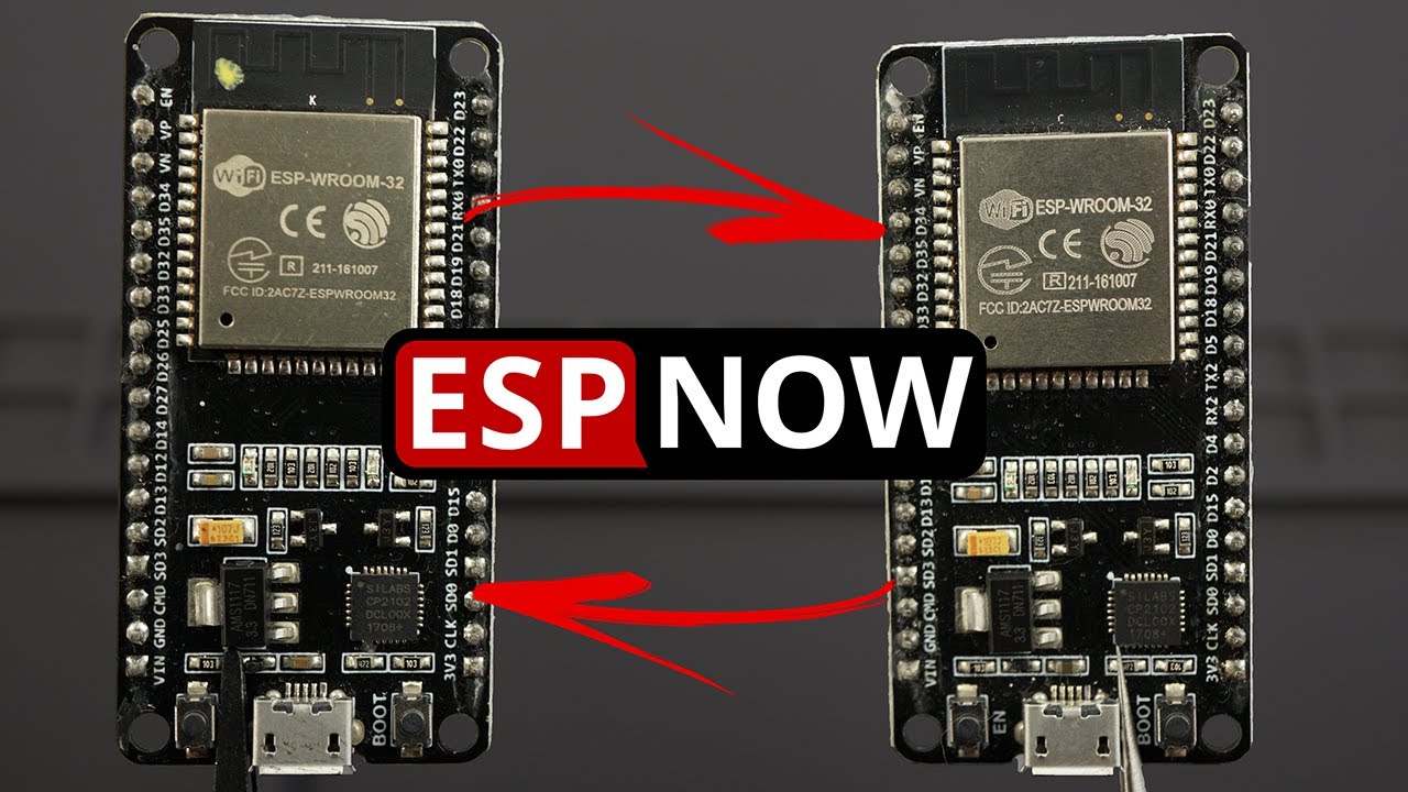

Suggest looking at, ESP-NOW
Depending on nearby objects 75 feet should be obtainable.
