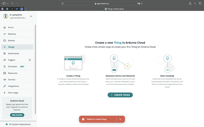

Not sure this is the right place to ask. But I have tried and tried making Things fail in Arduino cloud. I am new on the Arduino cloud and I have no idea why this happens.
I am new on Arduino IoT cloud and has paid a maker subscription yesterday. Before that I had a free subs in a month and had not this problem. This is frustrating as I cannot find any support with this topic.Help from any body who has experienced this before or has an idea what can cause this is very much appreciated.

Hey I have the same issue. Did you solve the issue or does it show the same error msg 'Failed to create thing' . I just signed up on Arduino cloud.
No I haven't. I tried to follow one of the templates in the ressources. That way there was created a thing for me. I was thinking maybe one should add devices first and then create things, but that did not help me either.
I am also facing the same issue. I have a free plan and have added 1 thing already. When I try to add the second thing, i get a message "Failed to Create Thing". Till yesterday, I was able to create things easily.

I'm also facing the same issue. I found the problem was that Arduino blocked some time zones. My Timezone is Asia/Kolkata, I changed the timezone to US/Canada Central and It worked.
But this is not the permanent solution to the problem, it is just you can work on it temporarily until this is fixed.
where did you change that?
In your local computer.
There is also a time zone up at the top of the page where you have set up, sketch and metadata. You find it under metadata.
