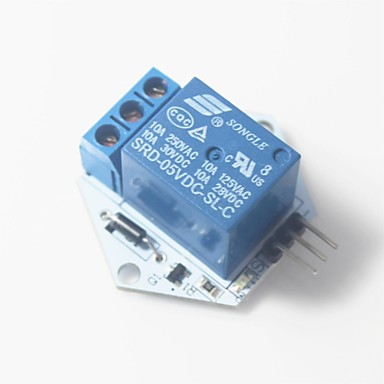

you mean something like this:
so if i give this thing power it will short pins ?
and about that optocoupler what kind of optocoupler do i need to buy for this do i need to watch out for any specific things when buying theseto be compatible with an arduino?
thanks for your replies
Two of those relays would work, although kind of overkill. It has the driver and flyback diode (required with any relay) plus an indicator LED. I was thinking of a small reed relay that could be directly driven by an output. Coil current of less than 30mA (greater than 200 ohm coil resistance). Like this reed relay. Addd a 1N914 or 1N4148 flyback diode.
