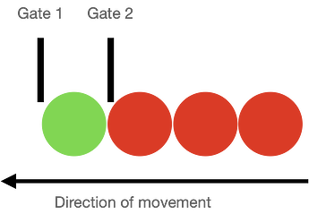

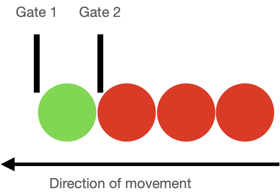

Do you have a way to reliably release one ball at a time (irrespective of the code) and prevent upstream balls from jamming and not falling through?
You may try putting the balls in line in a rail with two gated stops, say Gate 1 and Gate 2.
Gate 1 stops all the balls. This is the final gate. Gate 2 stops the second-to-last ball and the rest of the balls.
Releasing one ball would work like this:
Start with both gates closed.
  1. Open Gate 1. This allows the first (green) ball in line to roll down. All of the other (red) balls do not move, as they are stopped by Gate 2.
  2. Wait for green ball to move/fall.
  3. Close Gate 1. No balls move.
  4. Open Gate 2. All balls start moving towards Gate 1.
  5. Wait for balls to move until they reach Gate 1.
  6. Close Gate 2.
Each gate could be a short rod controlled by a servo. Gate 2 should be stronger.
For this particular approach you need a suitable power supply, your Arduino, a couple of servos and a a way to tell the program what rate you want, and to know what rate is set at the moment. This latter part can be achieved using a pot, a rotary switch, a couple of buttons, a display, or touch screen, you name it.
My point is that you first have to come up with a physical design or even a (manual) prototype, and then start thinking on the mechanical actuators (motors, sensor, switches, ...), and finally start programming. Questions will arise, such as how long to wait on steps 2 and 5? Is this a timed wait, or triggered by sensors? What happens when no more balls are left? ...
At least that is how I'd do it

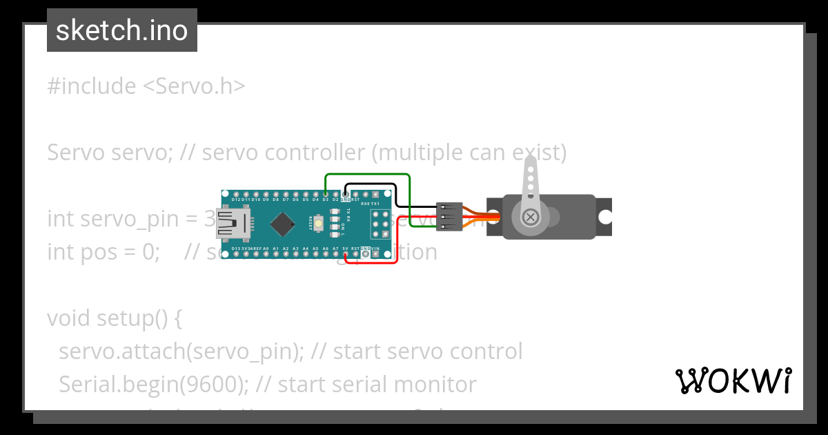

Here is a simulation from wokwi with human input of one servo. Look at the code. Not too lengthy.

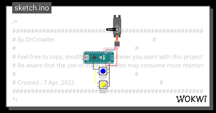

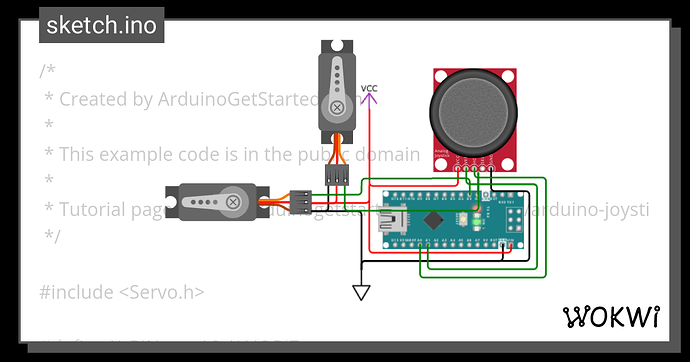

Here is another simulation from wokwi that is slightly more complex:
Most of the complexity is formatting the output for reading.

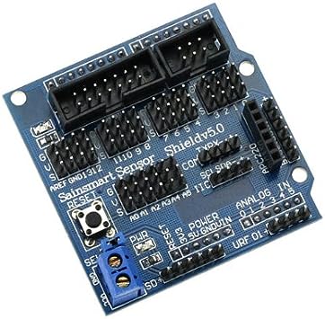

Also, can you run 5 servos from the 5v source on the Arduino? Will the usb connection provide enough power or do I need to buy a power supply plug?
It is not the most elegant fix probably, but will hopefully work!
Thanks
Save yourself some heartache and don't run even one servo off the Arduino supply. Add a separate supply for the servos. How many servos do you anticipate may be running simultaneously?

What does an external power supply look like for something like that? I have very limited electrical experience so would hope it was a simple solution to provide power from an external source?

Get such a sensor shield to make a proper power supply of servos used.
51RNJN3j4aL
A wall wart is about as simple as it gets. Check the current capacity of your selection. Cut the connector off and connect to a shield like @paulpaulson pictured. Be mindful of your polarity!
