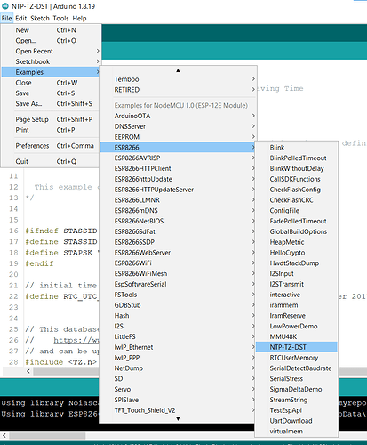

For the ESP8266 there is an IDE example. you will find it in
Examples/ESP8266/NTP-TZ-DST
but imho my stripped down versions are simpler to read.
