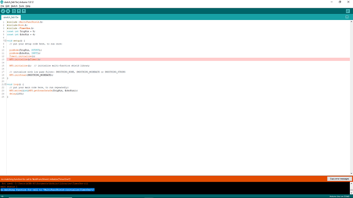

im using HCRS-04 Distance Sonar(?), LearningShield/MultiFunctional Shield, Arduino Mega328(?) for a certain self project. im trying to use distance sonar to gather some distance from a certain wall/object, then the distance will be display at Learning Shield/MultiFunctional Shield.
i am following different guides and pdf files. for example, i followed this guide. i also watch the video. _**https://www.mpja.com/download/hackatronics-arduino-multi-function-shield.pdf**_ page 10(here is the video __*- YouTube). in the video, his arduino IS working but when i tried to use it on my own arduino, it is not showing. it just show some random 7 segment light working but it doesnt change no matter what i do to sonar.
it always show," no matching function for call to 'MultiFuncShield::initialize(TimerOne*)'"

I do not have the shield your referring to but I downloaded and installed the MultiFuncShield-Library from the PDF you linked in your request. I also downloaded the code used (also linked in the PDF) and loaded the Sonar_Module sketch your also referring to and it compiled without errors for UNO in the 1.8.11 IDE.

But, the error you post is a compile error - you will get that attempting to even verify, without the board even being connected!
Post the full error output, as text, not an image (never post pictures of text unless you absolutely have to!). Click the button to copy the error message, and paste it in here. Use the </> button on the forum to enclose the error message in code tags so it is easier for us to read.
I suspect that the cause of it is related to the fact that you have multiple versions of TimerOne installed, but I can't really tell, because the key parts of the error message can't be seen in the picture.
