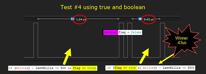

~800ns less if I use true and move the Flag test to the front. :slight_smile:
//Timing measurement done with a logic analyzer looking at D13
#define pulse13 PINB = 0x20; PINB = 0x20
boolean flag = false;
unsigned long lastMillis;
  pinMode(13, OUTPUT);
  pinMode(12, OUTPUT);
  pulse13;
  if (millis() - lastMillis >= 500 && flag == true)
      //This gave 1.24us
  pulse13;
  pulse13;
  if (flag == true && millis() - lastMillis >= 500)
      //This gave .44us
  pulse13;
  delayMicroseconds(100);
} //END of loop()
The compiler is smart enough to notice that 'flag' is initialized and never modified so it can be treated as a constant. One way to avoid having the compiler optimize away code that you want to time is to declare variables 'volatile'.
