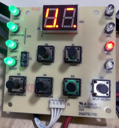

Hey all I am using a 2 digit 8 segment TM1650 Arduino library and I can't seem to find the setting for that? I can only find TM1650_DISPMODE_4x8 and TM1650_DISPMODE_4x7. No 2x8.
My setup looks like this when running the code below:
enter image description here

Looking at the pcb tracks only power, gnd, data and clock tracks seem to be going to the correct places. All others do not seem to be aligning like they are in the datasheet? Or maybe i am looking at it incorrectly?

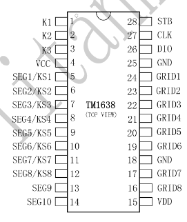

And looking at the datasheets for the 3 the pinouts look different (yet none look like the pinout of the pcb) and more pins.
TM1637:
TM1638:
TM1650:

Just trying you first display.println(F("HELLO !")); looks like this:
Does this help any?

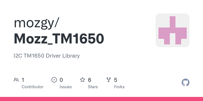

maybe try this lib
