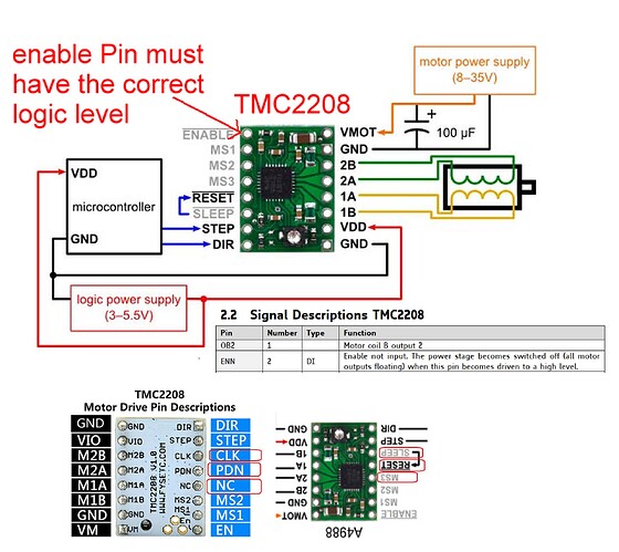

This is the connection I am using, nothing moves, but when I connect the enable to gnd it shakes and tries to move but does not finish turning
The photo I have posted is how I have it working with the a4988; The connection I use for the TMC is the same but I add a cable from the enable to gnd

What exact TMC2208-board are you using?
It is always a good idea to look up the datasheet of the used chips.
The TMC2208 has an enable-pin. Depending on what exact TMC2208-board you are using it might be that the enable-Input is free-floating and requires to be connected to either GND or Vcc.
Or it might be that this connection is already on the board.

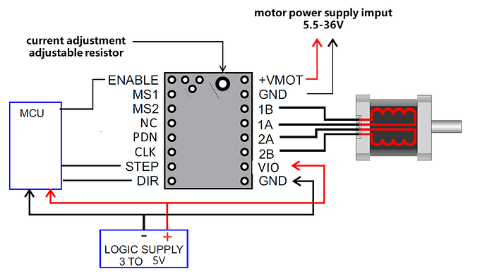

Really what I'm looking for is to be able to control three motors by pushbuttons; It is to sibir and lower a curtain, I want to control all three with an Arduino; I managed it with the first program I put in using the a4988 drivers (I have it connected to an expansion board), but they make a lot of noise. I have purchased some tmc2208 v1.2 and when I place them on the expansion board it does not work, I have also tried it without a board and nothing; I have played a little with chatgpt as I put in the following post but I have not been able to get it to move the motors either.
dear @golfo
did you really read what I have posted before?
What exact TMC2208-board are you using? There are many companies that build TMC2208-boards. And their products can deviate on details.
These details are important. If you really want help provide a link to exact that TMC2208-driver board that you have.

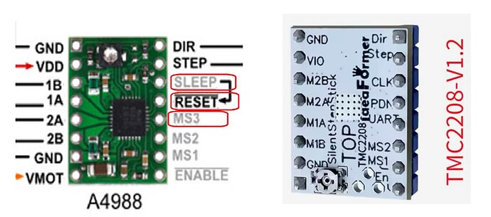

Did you check if your TMC2208-board is fully pin-compatible with the A4988 board,
so you can use it as a drop in replacement?
If you look at this comparising picture the pinout of these two boards are different
Did you do the test to connect the EN-input to ground / 5V?

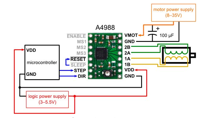

This is a schematic I found here
No idea if this is exactly your TMC2208-board.
Yes, I read it, but it was my fault that I was using a translator and I didn't understand it well. The driver I purchased is this one.
If you do a careful comparising of each and every pin between the A4988-driver and the TMC2208-driver:
what differencies to do read?

driver
Sorry, I thought the TMC2208 model was always the same; I bought it on Aliexpress.
The program I was using only uses the power connections, the motor connections and the two dir and step pins; since the TMC has those pins, I thought it would be compatible as well.
Your program does not use the power-supply connections.
What do you think will happen if you take away the powersupply-wires?
The schematic that you posted
shows an additional connection between two pins of the A4988 board.
Are you able to identify which connection this is?
