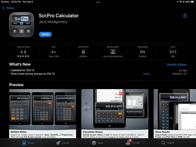

18,446,744,069,414,584,432 = 0xFFFFFFFF00000070
We can only have 4 bytes, therefore:
0x70 = 112 decimal
How did you get that number?? My calculator doesn't give me that...
Is there a special way of doing this math?

I don't have any apple devices, so I can't use that app.
I have no idea what would happen.
