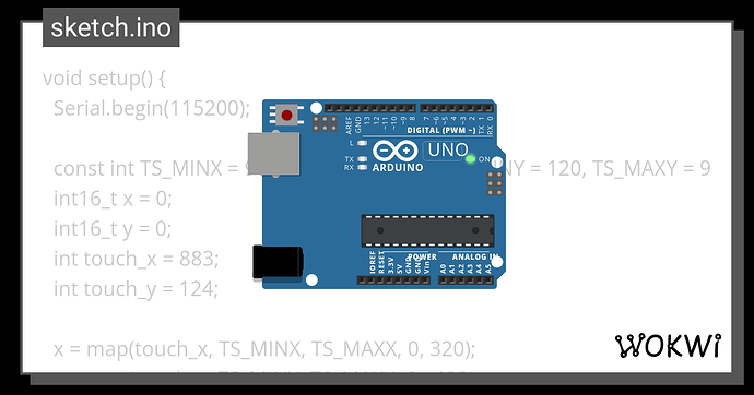

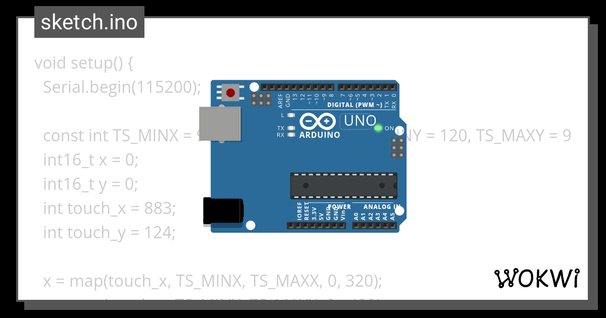

Hi!
Try this:
 const int TS_MINX = 905, TS_MAXX = 140, TS_MINY = 120, TS_MAXY = 945;
  int16_t x = map(touch.x, TS_MINX, TS_MAXX, 0, 320);
  int16_t y = map(touch.y, TS_MINY, TS_MAXY, 0,  480);
Using the value from your pics I can get this coordinates:
  (9, 2)            (321, 0)
(22, 470)         (316, 478)
Which makes sense to me.
You can check it here:
Best regards.
